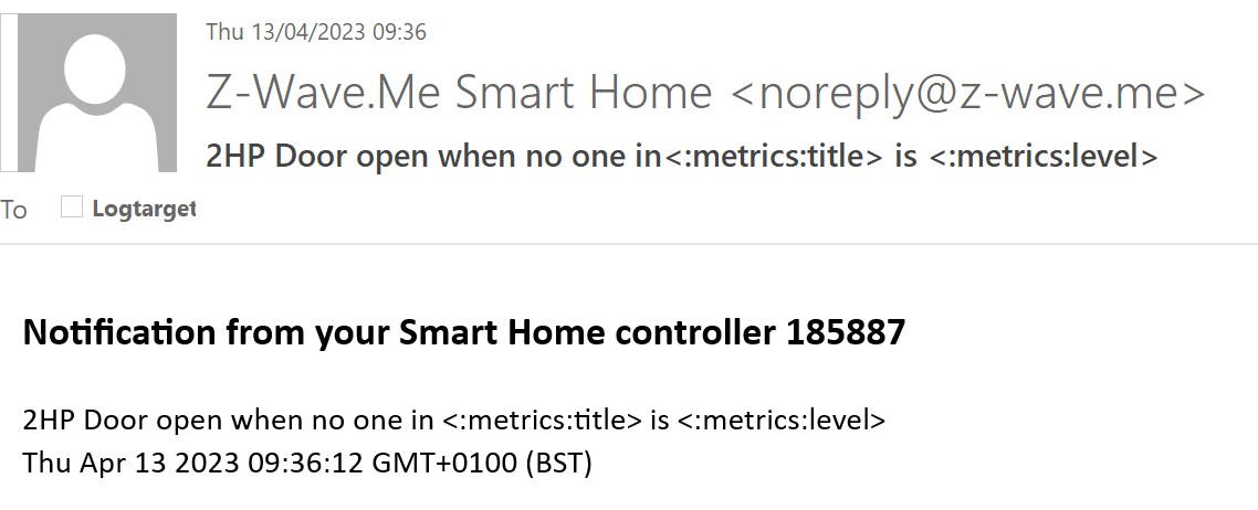

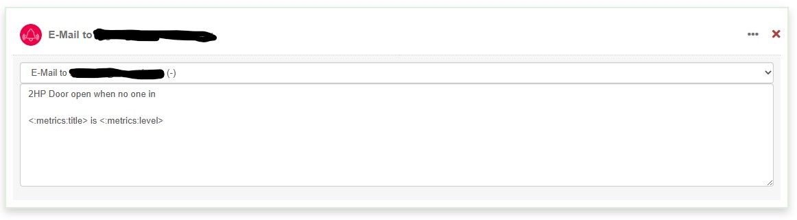

hmm not quite sure that works ...
email response
email response
Screenshot 2023-04-13 093916.jpg (71.87 KiB) Viewed 31648 times
config
config
Screenshot 2023-04-13 094057.jpg (33.68 KiB) Viewed 31648 times

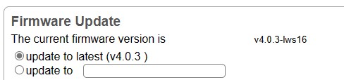

Sure you have Z-Way version 4.0.2 or upper?
Re: NotificationChannelEmail Trigger Details
Posted: 19 Apr 2023 11:42
by topcatsss
yup
4.0.3

Posted: 22 Apr 2023 02:16
This works only in device's notifications (go in device settings and set them there), but not in the Automation section and other modules like NotificationChannelEmail.
https://github.com/Z-Wave-Me/home-autom ... d92daff86e
But you can copy&paste the code to other modules (prepareMessage function). If you decide to do it, you can then contribute and make a pull request.
