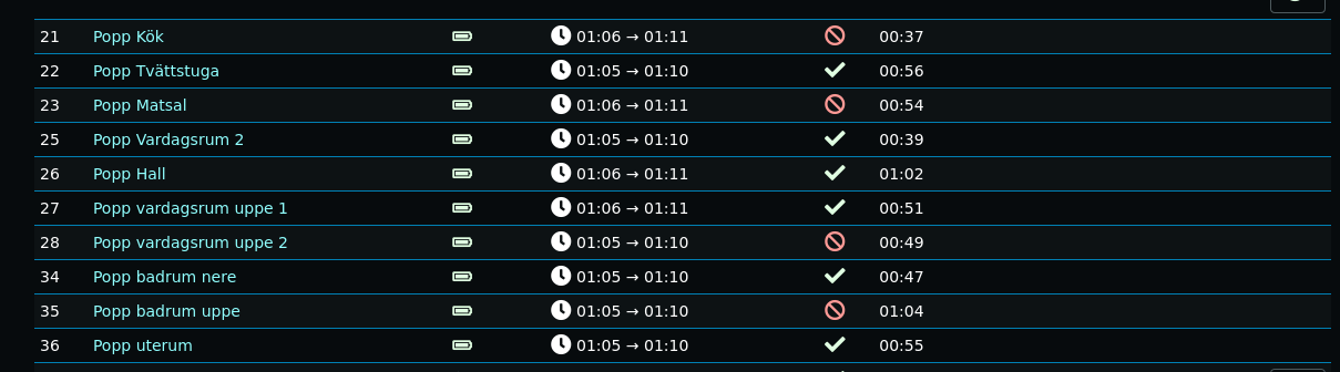

My battery devices turn into failed and gets back into working after a while
Screenshot 2023-05-26 at 01-06-11 Z-Wave Expert UI.png (64.05 KiB) Viewed 54258 times

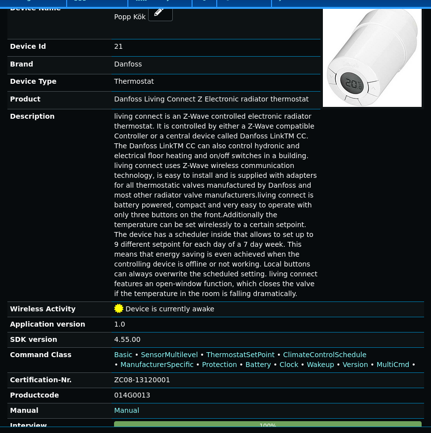

All my battery devices seem to be stuck in awake mode
Screenshot 2023-05-26 at 01-11-13 Z-Wave Expert UI.png (193.34 KiB) Viewed 54258 times
Devices doesn't listen when trying to manually set switch, I have tried to turn of switch #54 without any luck. Try check the logs for any clues:
https://www.dropbox.com/s/z3fwpn29jdrsh ... 1.log?dl=0
Job queue keeps piling up jobs:
https://www.dropbox.com/s/cja332urqp2lf ... I.png?dl=0
