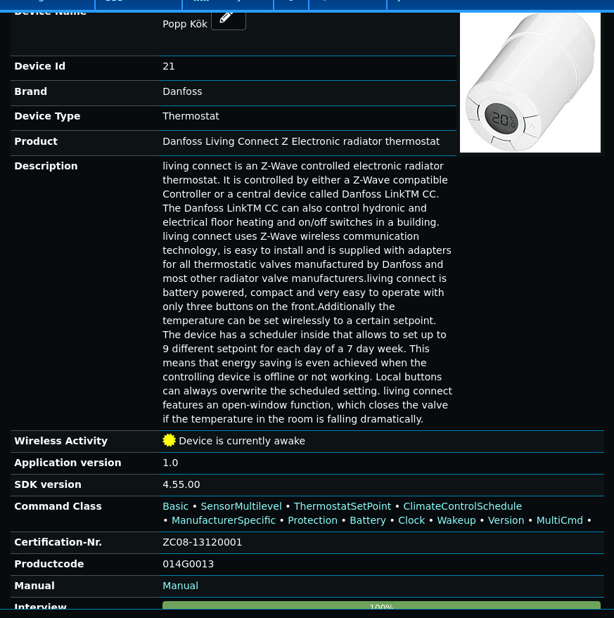

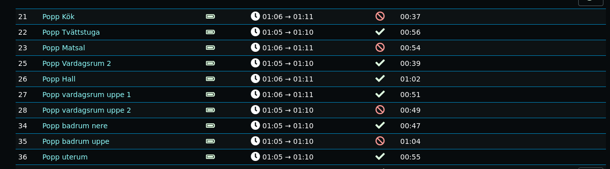

Re: Razberry Pro Firmware / SDK
Posted: 26 May 2023 02:33
by harre
My battery devices turn into failed and gets back into working after a while
Screenshot 2023-05-26 at 01-06-11 Z-Wave Expert UI.png (64.05 KiB) Viewed 54270 times
All my battery devices seem to be stuck in awake mode
Screenshot 2023-05-26 at 01-11-13 Z-Wave Expert UI.png (193.34 KiB) Viewed 54270 times
Devices doesn't listen when trying to manually set switch, I have tried to turn of switch #54 without any luck. Try check the logs for any clues:
