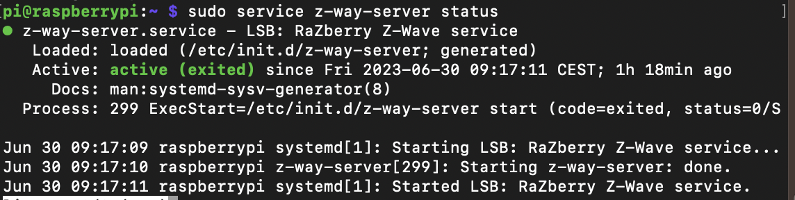

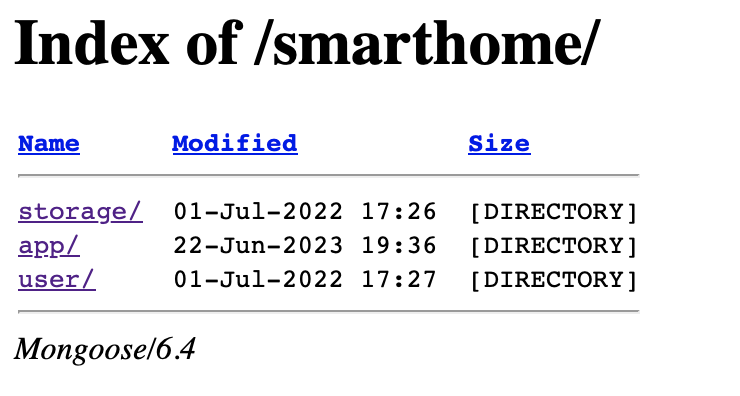

A couple of days after updating to the current version the WebUI it stops launching and shows the almost empty file structure only:
However the Z-way server is still working and the mobil app works, too:
What is wrong and how to fix?

You would be well served to understand how the /opt/z-way-server/htdocs/smarthome directory got corrupted. If it's not by a user action, then you likely have a corrupt SD card and you'll soon have much bigger issues. If SD card corruption is a possibility, I suggest you power down your Pi and copy important files from the SD card to a different storage media. At the very least, insert a USB thumb drive into the Pi and copy /opt files to the thumb drive.
As for recovering the contents of the /opt/z-way-server/htdocs/smarthome directory, one approach is to download and re-install z-way software. You'll need to be root to do these steps. Before you re-install the software, stop the z-way-server process and rename /opt/z-way-server directory to /opt/z-way-server_SAVE (i.e., run this command: mv /opt/z-way-server directory to /opt/z-way-server_SAVE). After you reinstall the z-way software, copy the /opt/z-way-server/htdocs/smarthome directory to /opt/z-way-server_SAVE/htdocs/smarthome. This command should do the trick: mv /opt/z-way-server_SAVE/htdocs/smarthome /opt/z-way-server_SAVE/htdocs/smarthome_BAD; cp -pr /opt/z-way-server/htdocs/smarthome /opt/z-way-server_SAVE/htdocs/smarthome. At this point, /opt/z-way-server_SAVE should be fixed. To revert to using the fixed z-way software instead of the reinstalled software, stop the z-way-server process and run: mv /opt/z-way-server /opt/z-way-server_NEW; mv /opt/z-way-server_SAVE /opt/z-way-server. Then start the z-way-server process.

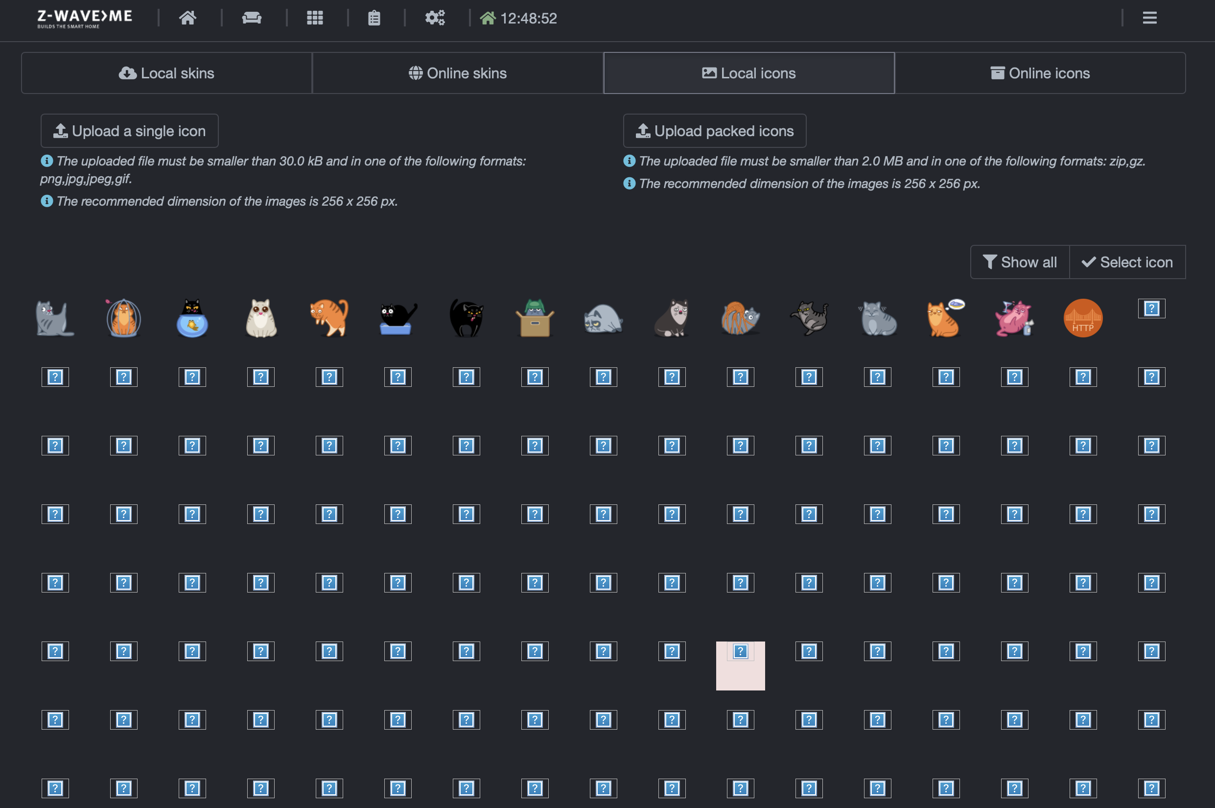

However: Even in the new installation most of the icons are missing.
The old icon folder was empty: /opt/z-way-server_SAVE/htdocs/smarthome/storage/img/icons. But why the icons are missing in the updated configuration (here the icon files are present in the folder, but not displayed as shown in the attachement).

If icon files were missing and now are present in directory /opt/z-way-server/htdocs/smarthome/user/icons and directory /opt/z-way-server/htdocs/smarthome/storage/img/icons, then your browser's cache needs to be refreshed. Try clearing your browser's cache for your Pi's URL. This should cause the icons to reappear in your browser.
Do you have a theory on how the icon files disappeared on your Pi? It's possible you've uncovered a Z-Way UI bug where the actions you took using the Z-Way UI caused the icon files to be deleted. Perhaps when your attempt to change to a new icon set failed, the Z-Way software did not restore the original icon files.
Re: Web UI is not launching
Those are custom icons. Icons, apps and skins are not saved in the backup. You need to install them. Just install them from the store and everything will be back
