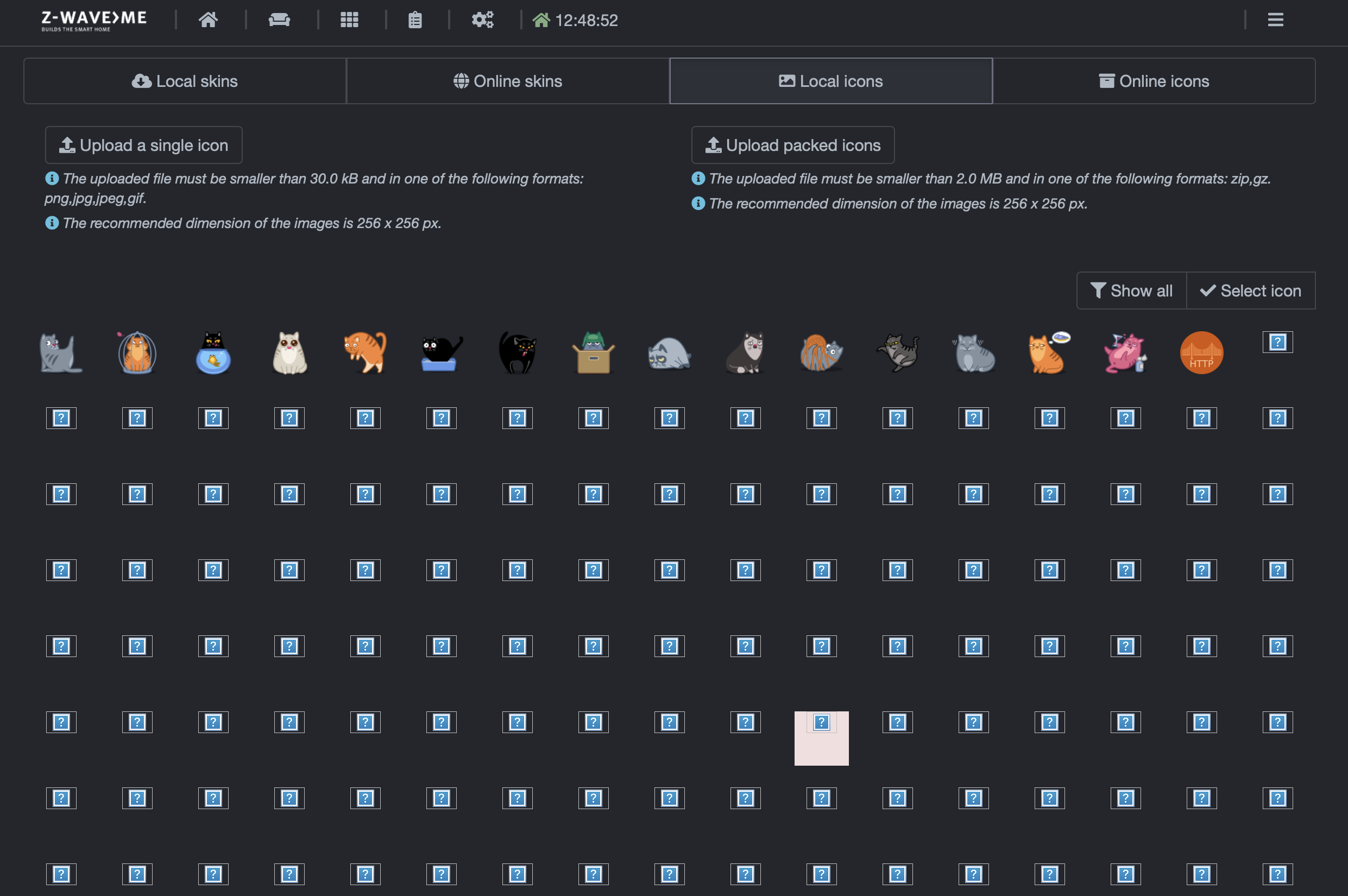

Thanks a lot. - After installing the firmware again the the WebUI started again. I saved the old configuration in ...SAVE as recommended.
However: Even in the new installation most of the icons are missing.
The old icon folder was empty: /opt/z-way-server_SAVE/htdocs/smarthome/storage/img/icons. But why the icons are missing in the updated configuration (here the icon files are present in the folder, but not displayed as shown in the attachement).

If icon files were missing and now are present in directory /opt/z-way-server/htdocs/smarthome/user/icons and directory /opt/z-way-server/htdocs/smarthome/storage/img/icons, then your browser's cache needs to be refreshed. Try clearing your browser's cache for your Pi's URL. This should cause the icons to reappear in your browser.
Do you have a theory on how the icon files disappeared on your Pi? It's possible you've uncovered a Z-Way UI bug where the actions you took using the Z-Way UI caused the icon files to be deleted. Perhaps when your attempt to change to a new icon set failed, the Z-Way software did not restore the original icon files.

Those are custom icons. Icons, apps and skins are not saved in the backup. You need to install them. Just install them from the store and everything will be back
