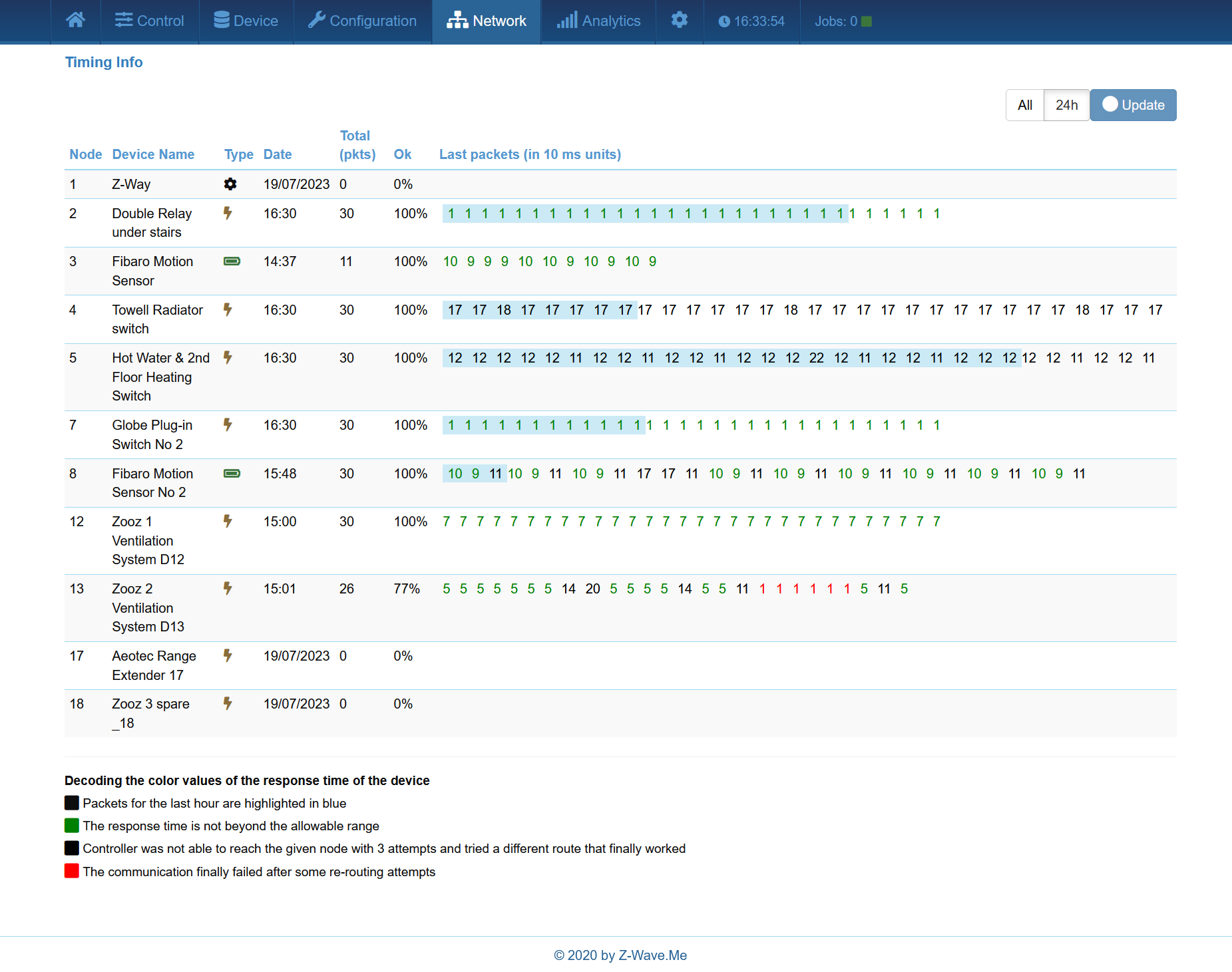

Using Expert UI, under Network / Timing Info, I sometimes see a series of red 1's as the times (under Last Packets in 10 ms units). Red indicates a failed transmission, but if so, surely it would not take 10 msec?? So what does this mean?
When I get a genuine failure, it is more like a red 250 (2.5 seconds).
I am using Zway v4.1.0, a Razberry7 with SDK Version: 7.17.00 and Serial API Version: 07.13
See below, Node 13:
Screenshot 2023-07-20 163411.png (193.14 KiB) Viewed 25087 times
Nodes 12 and 13 are side by side and one of the furthest from the R Pi controller.

Sometimes the SDK is very fast to say that it was not delivered. Better to check in the log, because I agree, it had to take longer. Please show the log of that moment

I'm not sure of exactly when it happened. It's run every 3 hours. I've looked at the z-way-server.log for each episode from 1800 the previous day to 1500 of the day (20 July), pulled out the relevant secion, and used Notepad++ to run a Compare. There are differences in the data values, but no obvious error meassage. I think I ran a Reorganistaion at 17:06 the previous day. The only thing I have spotted is that a Background Noise Level job sometimes gets started during the Node 13 run, although this Noise job seems to run every 30 seconds, so must also interfere with the other nodes as well. I attach the log extract for the 03:00 run, where the Background Noise Level job runs at 03:01:03.989 during the Node 13 run.
I will keep an eye on the Timing Info and try to pull out the actual log of when it happened.

Re: Timing info shows red 1 as time
There is nothing wrong in this log. The device is always reachable. the red one means the corresponding packet was not delivered
