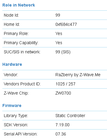

Controller info:

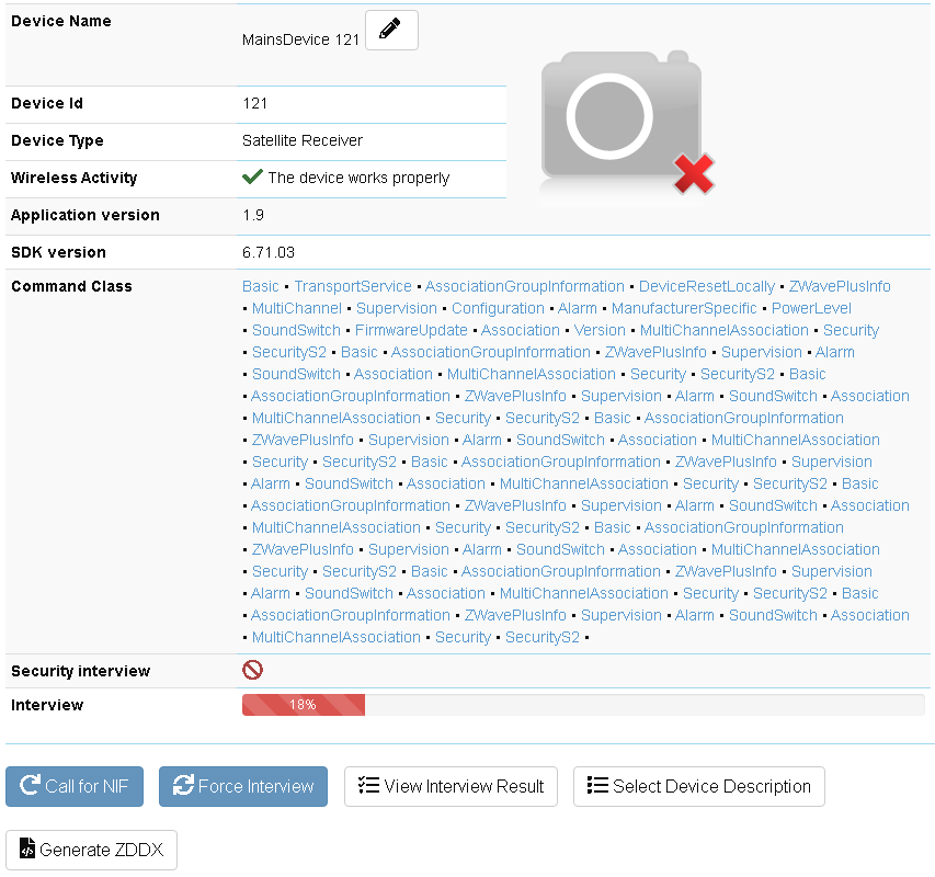

Expert UI shows device being added, popup saying to wait for S2 key, and then "S2 Timeout" is shown. Never prompted for any actual input.

Device interview gets stuck as probably expected:
I have tried this exclude+include process many many times now. Power cycled, completely removed power for a while.. The end result is always the same. And it is not just this device. Same issue with ID Lock 150.

Based on your RaZberry 7 Pro having node ID=99 (and not node ID=1), I'm guessing you've added your RaZberry 7 Pro controller by doing a controller change. Based on the log file showing spurious messages from node ID=1, I'm guessing your "old" Z-Wave controller is still active, perhaps on a second Pi. If these guesses are correct, there's a good chance you've accidentally made a mess of your Z-Wave network. To add to the confusion, the screenshot for device 121 shows you've added a mains powered device (i.e., plugged into an AC outlet, not battery-operated) that's a satellite receiver, when you're adding a doorbell. When I've accidentally messed up my Z-Wave network, I found the best solution was to revert to a clean installation and start over.

I also see your RaZberry 7 Pro is running firmware 7.36 which should be upgraded to 7.38.

Your issue is hidden here:
[2023-10-15 12:21:42.621] [I] [zway] Controller was not granted S2 keys - skipping device interview
Looks (and supported by the fact that your controller has node Id = 99) that you included Z-Way in another network and then made it SIS. So Z-Way has not got keys from the old Primary.
You need to do:
zway.devices[99].data.secureControllerId=99
This should solve the problem
