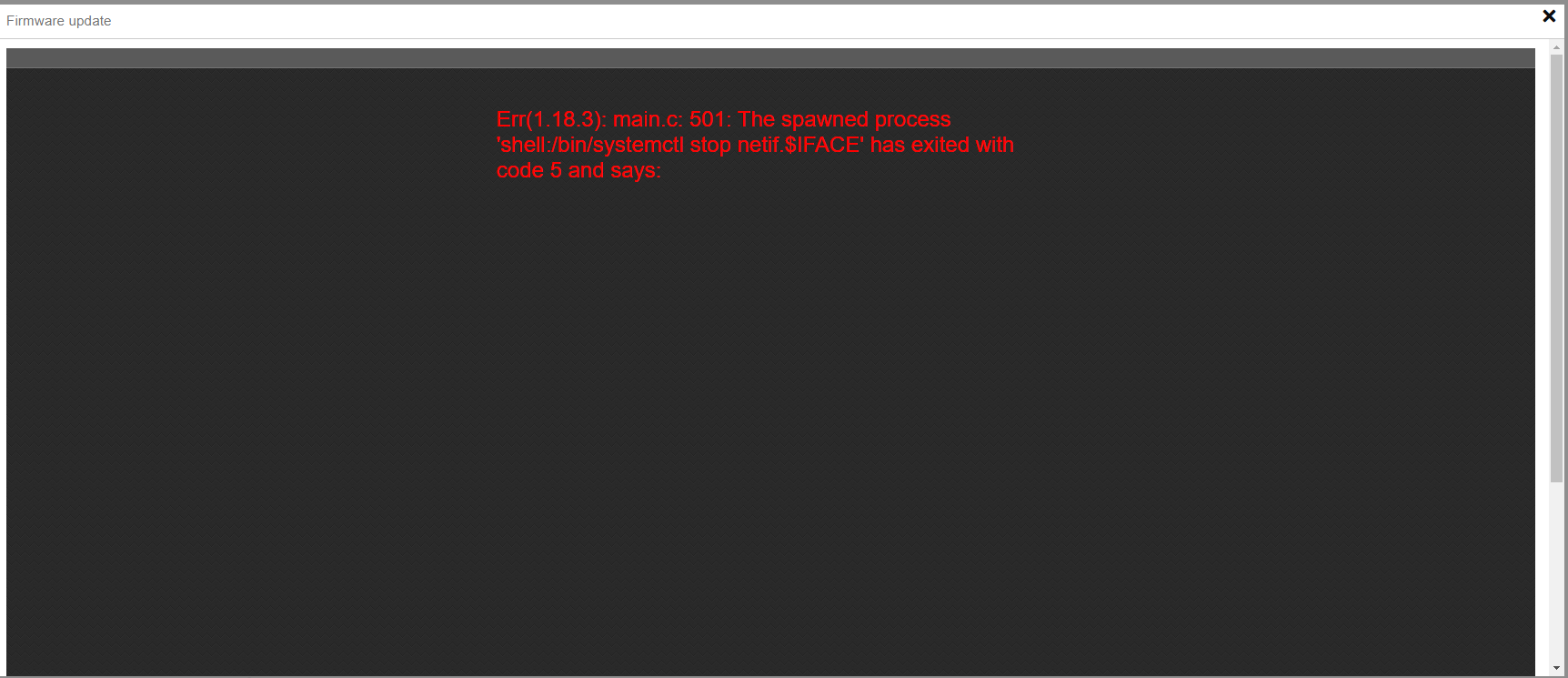

hello
Get this error using RaZberry Configuration Interface, when trying to restart z wave or reboot :
Err(1.18.3): main.c: 501: The spawned process 'shell:/bin/systemctl stop netif.$IFACE' has exited with code 5 and says:
but no message indicated.
any ideas to fix this?
RaZberry by Z-Wave.Me
Vendors Product ID: 1025 / 257
Z-Wave Chip: ZW0700

Re: 4.1.2 Razberry zw0700 error
Post by otverber »
Trying to Z-Wave restart in the firmware update menu
gives this message and no restart of z-wave
2024-03-12 (1).png (64.45 KiB) Viewed 79293 times
We will check it. Meanwhile please ssh to your box and do
sudo /etc/init.d/z-way-server restart

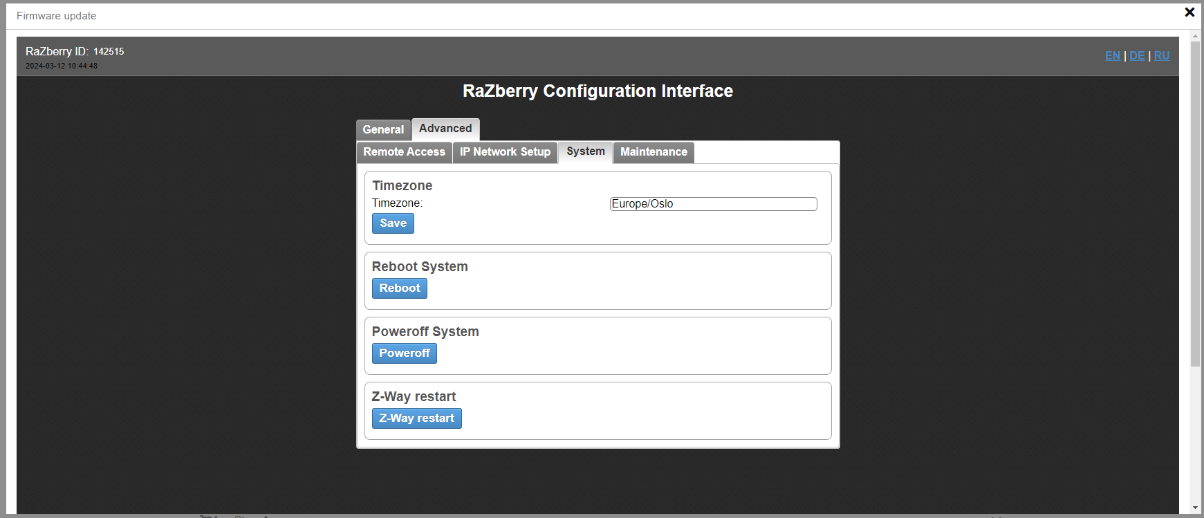

Upgrade to 4.1.4 trough the interface worked, but the same error message occured during the process, I.e. no upgrade in process window active.
After upgrade, the select z-way restart in the system/advanced menu brings up the same error message as before..
Not fixed then ?
Best regards
Looks, our list of IP interfaces does not match yours. Please do:
ip a; ip l
