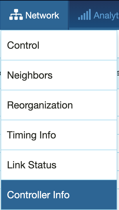

You made that much harder than you need too...
Expert UI:

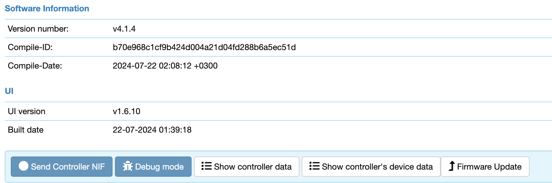

Click firmware update

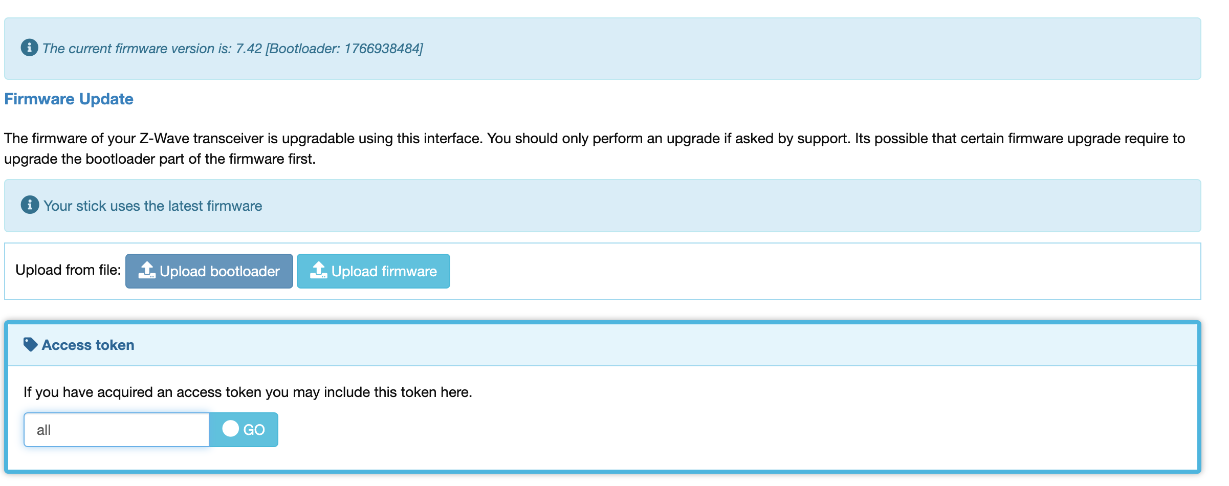

use the token of all and click go
Screen Shot 2024-11-03 at 9.11.09 AM.png (157.41 KiB) Viewed 92516 times
Update the firmware and it will download what it needs to download.
