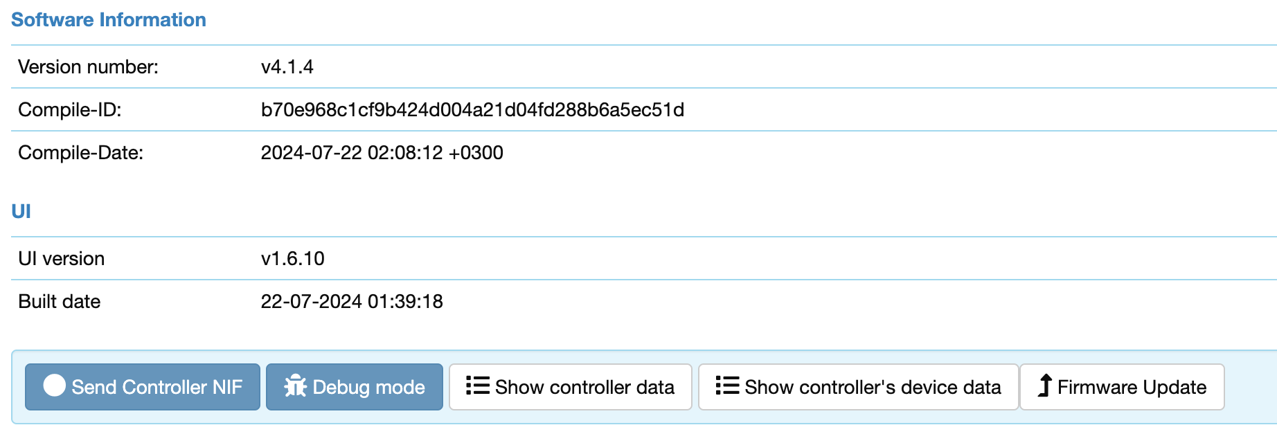

Expert UI:
Screen Shot 2024-11-03 at 9.10.29 AM.png (47.62 KiB) Viewed 92530 times

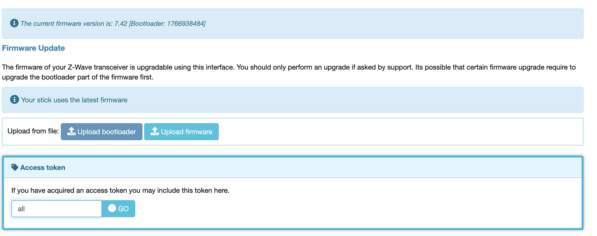

Click firmware update
Screen Shot 2024-11-03 at 9.10.50 AM.png (97.8 KiB) Viewed 92530 times
use the token of all and click go
Screen Shot 2024-11-03 at 9.11.09 AM.png (157.41 KiB) Viewed 92530 times
Update the firmware and it will download what it needs to download.
