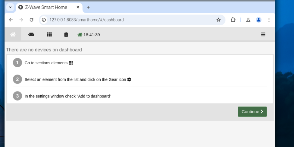

I have a local user ( ie defined as access only via localhost 127.0.0.1 ) .
I created it because I wanted to force a login on my local wifi network .
This, because all logins prior to this had been remote ( though I didn't specify one way or another )
So I created the local user, logged in, and that login was remote ( as should not be allowed , as far as I understand ). You can see this in the screenshot .
I was able to log in "locally" , the only time so far by VNC connection to the Pi where Z-way is running and going to 127.0.0.1:8083 in a browser from its desktop.
In both cases ( the remote login from an iPhone and the real local one ) , there are no devices , elements or anything. - so that is being blocked I guess ( for some reason - but *not* because it is "not local " ! ).

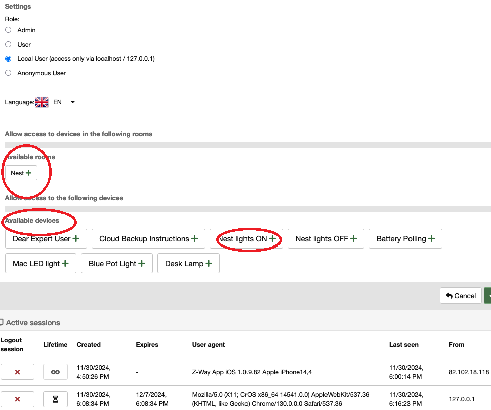

The local user should have devices  and rooms available NB  also evidence of remote login

local user has no access to anything despite seemingly having access in settings

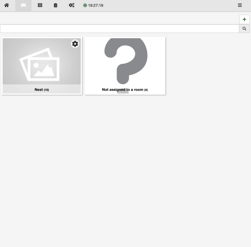

I will do as you ask (attached ) but I don't think there is much to be gleaned from this.
Screenshot 2024-12-06 at 19.27.31.png (106.84 KiB) Viewed 136810 times
Screenshot 2024-12-06 at 19.27.18.png (53.06 KiB) Viewed 136810 times

O,K. maybe I have to check in my installation. But in your first screenshot we see available rooms and available devices.
Did you add them by clicking on the green cross to get them in the "allowed" list. Then they should apear with a red cross to deactivate.

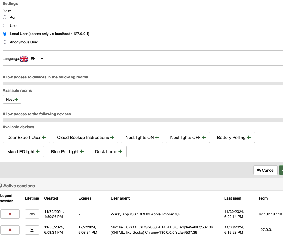

Ups, may be my mistake, as I wrote your first screenshot, seems that it is the second. I can´t see the first image.
I editet your screenshot and you will see it :-) If you click on on of the green crosses, then this should be visible for local user.
