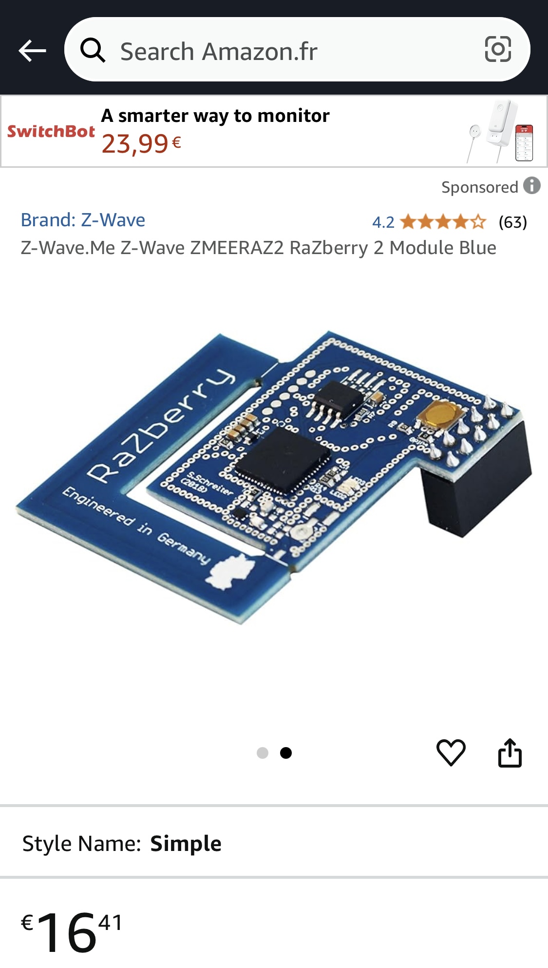

I see what appear to be rev 2 boards on Amazon ( from a company in France ) for under €17 .
Would you mind having a look at my photo and see if they look right ?
The logo etc aren’t quite the same as mine which says Zwave.me.
Thank you

Yes, that is the rev 2 RazBerry card. It uses a 500-series chip and works perfectly fine with Z-Way software. The current RazBerry cards (RaZberry 7 and RaZberry 7 Pro) use a 700-series chip. If you're okay with reduced range, higher latency and no long range support, the rev 2 RazBerry card is an excellent deal. Note that the most recent generation of Z-Wave chips from Silicon Labs are the 800-series. However, as best as I can tell, Z-Wave.Me does not sell an 800-series Z-Wave controller. Other vendors sell 800-series based controllers (Zooz ZAC93 is an example), but those controllers are not compatible with Z-Way software.

Another factor to consider is that the Razberry 2 board (500 series) is not a universal board, there is actually three different models based upon the frequency.
https://z-wave.me/products/razberry-old/
RaZberry comes in three different versions depending on the transmitting frequency used:
ZMEERAZ2: Version for all frequencies around 868 MHz (EU, Russia, India — default is EU).
ZMEARAZ2: Version for all frequencies around 921 MHz (Australia/Brasil, Japan, Korea — default is Australia/Brasil)
ZMEURAZ2: Version for all frequencies around 908/915 MHz (USA, Israel — default is USA)
Since it is Amazon France and the seller is also in France, these are most likely the EU boards and fine for EU use. My opinion, if you needed a Razberry board, the Razberry 7 series are far superior.
https://www.silabs.com/wireless/z-wave/ ... s-modules#
https://www.silabs.com/wireless/z-wave/ ... modem-soc#
The sensitivity on the 500 series is -98dBm whereas the 700 series is 106dBm.
