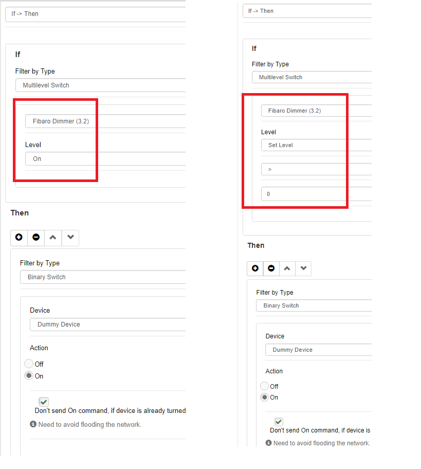

I am trying to capture events from "Fibaro dimmer 2" using "If->Then" app, but looks like this way doesn't work. I have tried all ways (see screenshot) but failed. Could someone help me?

Looks like specific behavior of "If->Then" for any dimmer. Workaround - paired dimmer with binary dummy switch, and set events on dummy.
