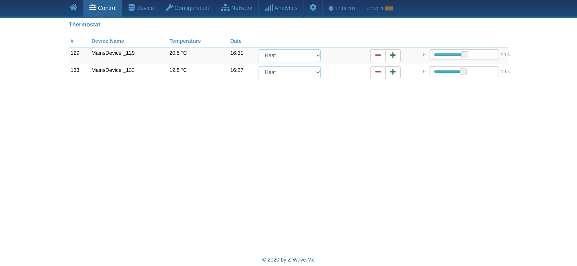

I have forwarded the info to Namron and to Elektroimportoren, but I'm not sure what will happen. I guess they should provide an updated firmware ?
And get the product properly listed in z-wave alliance ?
In expert view the thermostate mode can be varied between off/heat/energy save heat; this setting is not available in standard mode..
Screenshot 2021-12-14 17.00.11.png (86.94 KiB) Viewed 95401 times
I Guess there should be a comfort temperature at heat ; a 5-10 deg c lower temperature for energy Saving etc. Then present modes and night/day could be used to trigger switching between comfort, energy saving or off.
Parametre 7 set to 1 activates thermostate mode as intended.
