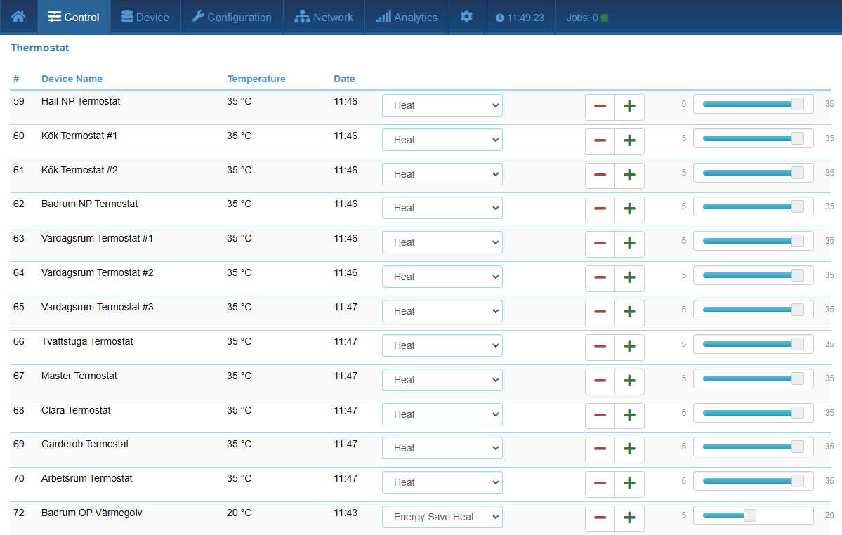

After finally some time of stable z-wave, when winter really comes I realize my thermostats are not working as before.
I have a set of Everspring AC301-1 devices (https://products.z-wavealliance.org/products/3772) rebranded as Nexa ZRT-106 (https://nexa.se/smarta-hem/z-wave/zrt-106).
When attempting to change the target temperature of a device, the GUI resets after a few seconds of wait - regardless if I force wake the device before making the change, or not. It always sets the device back to 35 degrees and Heat mode.

[2025-01-06 11:38:03.475] [W] [zway] Node 70:0 CC Supervision: Matching Supervised Setter not found (Setter failed)
It's failing to set the setpoint and then reverts to the old value..

[2025-01-06 18:55:16.462] [D] [zway] RECEIVED: ( 01 04 01 13 01 E8 )
[2025-01-06 18:55:16.462] [D] [zway] SENT ACK
[2025-01-06 18:55:16.462] [D] [zway] Delivered to Z-Wave stack
[2025-01-06 18:55:16.675] [D] [zway] Job 0x3b: deleted from queue
[2025-01-06 18:55:18.852] [D] [zway] RECEIVED: ( 01 0B 00 04 00 4E 03 22 02 00 B7 00 2A )
[2025-01-06 18:55:18.853] [D] [zway] SENT ACK
[2025-01-06 18:55:18.853] [D] [zway] SETDATA devices.78.data.lastReceived = 0 (0x00000000)
[2025-01-06 18:55:18.854] [W] [zway] Node 78:0 CC ApplicationStatus: Request rejected by device application layer, but can't find the rejected command in the queue
[2025-01-06 18:55:21.158] [D] [zway] RECEIVED: ( 01 1D 00 13 6C 00 01 CC 00 B6 7F 7F 7F 7F 01 01 01 00 00 00 00 42 04 00 00 7F 7F 7F 7F 7F DE )
[2025-01-06 18:55:21.158] [D] [zway] SENT ACK
[2025-01-06 18:55:21.158] [I] [zway] Job 0x13 (ThermostatSetPoint Set to node 78): Delivered
[2025-01-06 18:55:21.158] [D] [zway] SendData Response with callback 0x6c received: received by recipient
[2025-01-06 18:55:21.158] [D] [zway] SETDATA devices.78.data.lastSendInternal = **********
[2025-01-06 18:55:21.158] [D] [zway] SETDATA devices.78.data.lastSend = 37317 (0x000091c5)
[2025-01-06 18:55:21.158] [D] [zway] Job 0x13 (ThermostatSetPoint Set to node 78): success
[2025-01-06 18:55:21.158] [I] [zway] Removing job: ThermostatSetPoint Set to node 78
[2025-01-06 18:55:21.166] [D] [zway] RECEIVED: ( 01 0B 00 04 00 4E 03 22 02 00 B6 00 2B )
[2025-01-06 18:55:21.166] [D] [zway] SENT ACK
[2025-01-06 18:55:21.166] [D] [zway] SETDATA devices.78.data.lastReceived = 0 (0x00000000)
[2025-01-06 18:55:21.166] [I] [zway] Job 0x13 (ThermostatSetPoint Set to node 78): Request rejected by device application layer
[2025-01-06 18:55:23.213] [D] [zway] Node 78:0 CC ThermostatSetPoint: Unsolicited report not received, sending Get
[2025-01-06 18:55:23.213] [I] [zway] Adding job: ThermostatSetPoint Get to node 78
[2025-01-06 18:55:23.223] [D] [zway] SENDING (cb 0x6d): ( 01 0A 00 13 4E 03 43 02 01 05 6D 83 )
[2025-01-06 18:55:23.230] [D] [zway] RECEIVED ACK
[2025-01-06 18:55:23.230] [D] [zway] RECEIVED: ( 01 04 01 13 01 E8 )
[2025-01-06 18:55:23.230] [D] [zway] SENT ACK
[2025-01-06 18:55:23.230] [D] [zway] Delivered to Z-Wave stack
[2025-01-06 18:55:24.418] [D] [zway] RECEIVED: ( 01 1D 00 13 6D 00 00 74 00 B6 7F 7F 7F 7F 01 01 03 00 00 00 00 42 01 00 00 7F 7F 7F 7F 7F 61 )
[2025-01-06 18:55:24.419] [D] [zway] SENT ACK
[2025-01-06 18:55:24.419] [I] [zway] Job 0x13 (ThermostatSetPoint Get to node 78): Delivered
[2025-01-06 18:55:24.419] [D] [zway] SendData Response with callback 0x6d received: received by recipient
[2025-01-06 18:55:24.419] [D] [zway] SETDATA devices.78.data.lastSendInternal = **********
[2025-01-06 18:55:24.419] [D] [zway] SETDATA devices.78.data.lastSend = 37632 (0x00009300)
[2025-01-06 18:55:24.419] [D] [zway] Job 0x13 (ThermostatSetPoint Get to node 78): success
[2025-01-06 18:55:24.419] [I] [zway] Waiting for job reply: ThermostatSetPoint Get from node 78
[2025-01-06 18:55:24.430] [D] [zway] RECEIVED: ( 01 0E 00 04 00 4E 06 43 03 01 22 01 5E B5 00 34 )
[2025-01-06 18:55:24.430] [D] [zway] SENT ACK
[2025-01-06 18:55:24.430] [D] [zway] SETDATA devices.78.data.lastReceived = 0 (0x00000000)
[2025-01-06 18:55:24.430] [D] [zway] Received reply on job (ThermostatSetPoint Get to node 78)
[2025-01-06 18:55:24.431] [D] [zway] SETDATA devices.78.instances.0.commandClasses.67.data.1.size = **********
[2025-01-06 18:55:24.431] [D] [zway] SETDATA devices.78.instances.0.commandClasses.67.data.1.precision = **********
[2025-01-06 18:55:24.431] [D] [zway] SETDATA devices.78.instances.0.commandClasses.67.data.1.deviceScale = 0 (0x00000000)
[2025-01-06 18:55:24.431] [D] [zway] SETDATA devices.78.instances.0.commandClasses.67.data.1.deviceScaleString = "°C"
[2025-01-06 18:55:24.431] [D] [zway] SETDATA devices.78.instances.0.commandClasses.67.data.1.intVal = **********
[2025-01-06 18:55:24.431] [D] [zway] SETDATA devices.78.instances.0.commandClasses.67.data.1.val = 35.000000
[2025-01-06 18:55:24.431] [D] [zway] SETDATA devices.78.instances.0.commandClasses.67.data.1.setVal = 35.000000
[2025-01-06 18:55:24.431] [D] [zway] SETDATA devices.78.instances.0.commandClasses.67.data.1 = Empty
Where relevant lines seem to be:
which then yields
[2025-01-06 18:55:21.166] [ I] [zway] Job 0x13 (ThermostatSetPoint Set to node 78): Request rejected by device application layer
Not sure why it resolved the issue last time but not now..
EDIT: When trying with other devices it seems to work. So only the one I have been testing with now is stuck.
MrRusch
Posts: 45
Joined: 23 Jul 2019 09:11
Re: Everspring AC301-1 ThermostatSetPoint Setter Failed
Post by MrRusch »
OK so the one I was testing with was rejecting the change as it had yet to be AdAP calibrated. After that was completed, it works fine.
Issue resolved!
