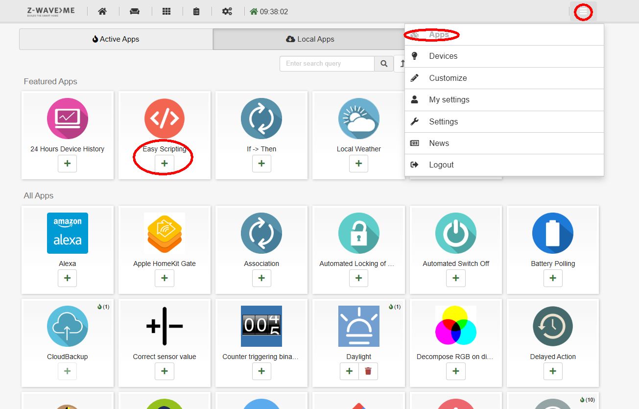

I've attached a screenshot that shows how to add an Easy Scripting app. From the main UI, click on the three horizontal bar icon, choose "Apps" from the pulldown menu and click on the "+" button for the Easy Scripting app. Although there's a learning curve to using this app, I think it's worth the effort, assuming you're comfortable writing a small amount of JavaScript code. I rely on this app to support the Zooz Zen 32 scene controller - the app responds to scene requests and controls the LED indicators.
Easy Scripting.jpg (101.17 KiB) Viewed 96320 times
