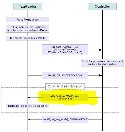

The BeNEXT/iHome Tag Reader does not work anymore well since I have migrated to Z-Way version 3 (v3.0.1). Or more precisely, the optional notification does not work anymore reliably. The reason is that the Z-Way controller has to issue the notification to the Tag Reader very quickly after receiving an alarm report. If this notification is not issued sufficiently quickly, the Tag Reader falls back to sleep and will not receive the notification from the controller.
The quick reaction to the alarm event has been ensured by binding the notification (binary switch) command to the alarm event. This was working well with the different version 2 releases:
zway.devices[TagReaderIndex].Alarm.data[6].event.bind(function() {
   zway.devices[TagReaderIndex].SwitchBinary.Set(true);
It seems that Z-Way version 3 does not react sufficiently quickly anymore. The Tag Reader falls back to sleep and plays the notification sound only the next time it wakes up.
The protocol between the Tag Reader and Controller will be attached as reference.
I hope the Z-Way controller reaction speed can be increased to make this Tag Reader working again in the expected manner.

I have checked the logs and found the Tag Reader event is received pretty much immediately (saying in less than 0.2 seconds). The job to respond with the SwitchBinary.Set command is then also added immediately, but the completion of this job is then delayed by 4-7 seconds. This was the summary, the details are here:
Tag reader event is received:
[2020-03-08 18:39:07.544] [D] [zway] RECEIVED: ( 01 14 00 04 00 16 0A 71 05 00 00 00 FF 06 06 01 02 BB 00 01 07 C6 )
[2020-03-08 18:39:07.545] [D] [zway] SETDATA devices.22.instances.0.commandClasses.113.data.6.event = 6 (0x00000006)
[2020-03-08 18:39:07.547] [D] [zway] SETDATA devices.22.instances.0.commandClasses.113.data.6.eventString = "Keypad Lock Open Operation"
Acknowledge is initiated (SwitchBinary.Set command is added):
[2020-03-08 18:39:07.548] [I] [core] Send acknowledge to Tag Reader 22 (SwitchBinary.Set)
[2020-03-08 18:39:07.549] [I] [zway] Adding job: SwitchBinary Set
Acknowledge (SwitchBinary.Set) is delivered:
[2020-03-08 18:39:11.449] [I] [zway] Job 0x13 (SwitchBinary.Set): Delivered
So it takes 4 seconds in this example to deliver the SwitchBinary.Set command to the Tag Reader, after receiving the alert. But since the Tag Reader goes quickly again into sleep mode after sending the alert, it will not be ready anymore to receive the SwitchBinary.Set command. This command should be executed with a higher priority.
The log file that contains 3 sequence for 3 Tag Reader events has been attached. It contains further details about the stack activities (log level 0 has been used).
I hope you can give me an advice how the SwitchBinary.Set command can be returned quicker after getting the alert from the Tag Reader.
Thanks!

The clue is here:
[2020-03-08 18:39:07.549] [I] [zway] Adding job: SwitchBinary Get
[2020-03-08 18:39:11.180] [D] [zway] RECEIVED: ( 01 0C 00 04 00 16 02 84 07 BB 00 01 07 DD ) <--------------------
[2020-03-08 18:39:11.181] [I] [zway] Node 22:0 CC Wakeup: Wakeup notification
It is not allowed to send packets to sleeping devices unless they tell us to do that by sending a NIF or Wakeup notification. Because most of sensors are sending alarm notifications and goes into sleep ASAP. So to be able to send the SwitchBinary Set we have to wait for a Wakeup notification. Note that it comes 4!!! seconds after the actual Alarm. This is a device problem and should be fixed by BeNext.
