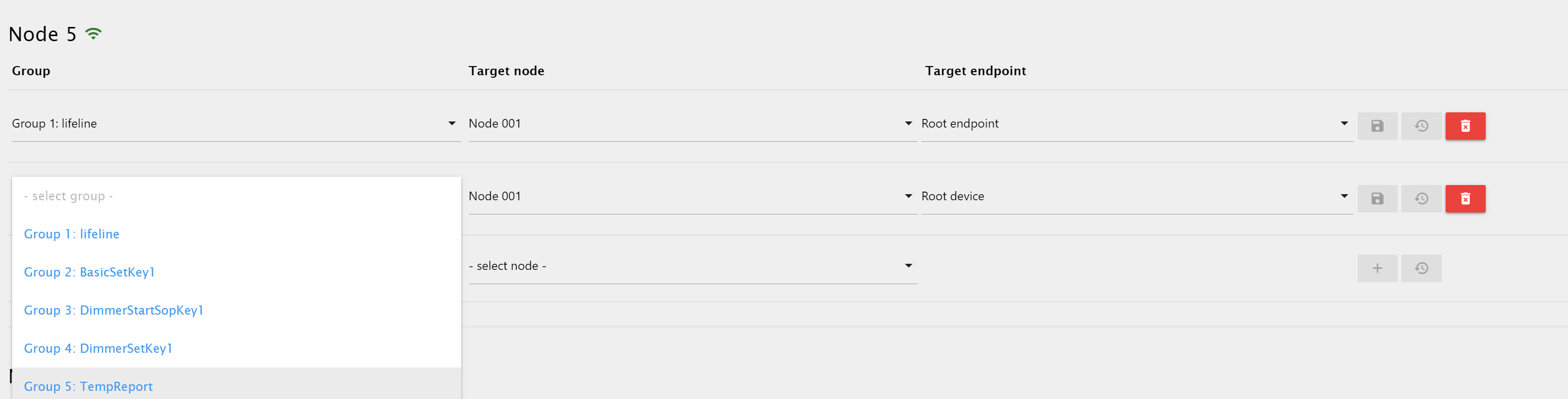

I am running RaZberry/Z-Way v2.3.0 with 2x Qubino Flush Dimmer (ZMNHDD1) and Qubino Flush 1 relay (ZMNHAD1).
My Problem is:
If I switch the Dimmer Module (or the Relay) with the normal Wall Switch (bi-stable Switch) thats wired to the Module the Status (on/off) dosen't get updated in the Z-Way UI.
I have tried to fix the Problem by Associating the Group 4 Association (multilevel set - thats triggered at change of dimmer state) from the Dimmer to Z-Way via the ExpertUI. (see Attached Screenshot)
Now there is a new Element in the Z-WayUI that shows the Correct Status of the Dimmer but the Real Dimmer Element in the Z-WayUI is still not updated. :cry:
I am new to Z-Way and Z-Wave so maybe i missed something. I hope you guys can help me.

I found the Problem!
Maybe there was a Problem with Inclusion...
But here is how i got my Qubino Moduls working as expected:
1. I removed all Associoations i tried before
2. I removed the lifeline Association (via Expert commands -> MultiChannel Association -> Group:1 Node:Z-Way instance:0 -> Remove)
3. I set a normal lifeline Association to Z-Way (via Expert commands -> Association -> Group:1 Node:Z-Way -> Set)
Now it works! If i switch via my Wall Mounted Switch the Status gets updated.
Qubino Flush 1 relay (ZMNHAD1), Flush Dimmer (ZMNHDD1), Flush 1D relay (ZMNHND1) are working 100% 8-)
