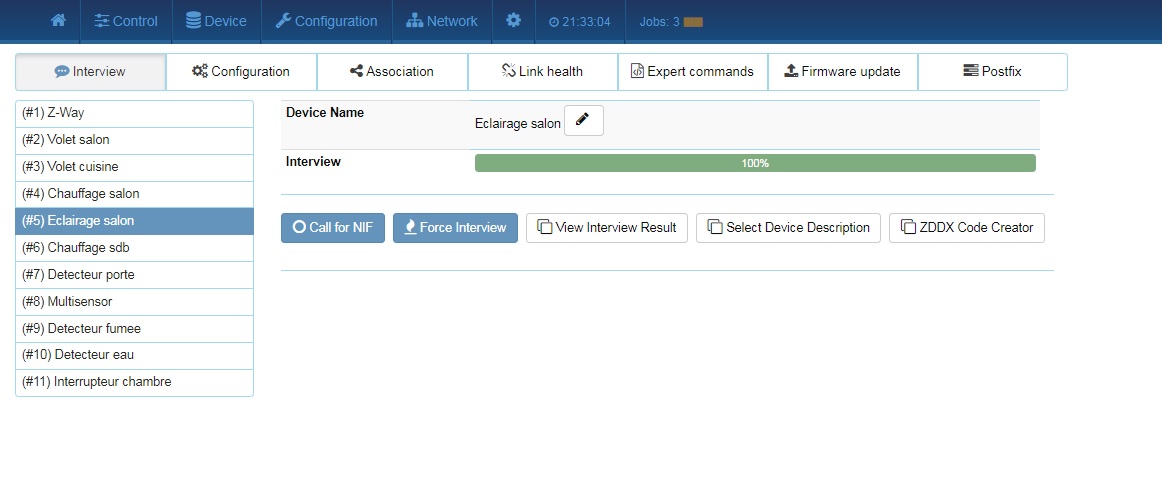

I edited the xml files for devices: Neo Coolcam NAS-SC01Z, Neo Coolcam NAS-WR01ZE and Qubino ZMNHJD1.
I added them with the command:
cd /opt/z-way-server/ZDDX
sudo python ./MakeIndex.py
Everything works fine but since I upgraded to v3.0.0-rc16 nothing appears in the interview tab for these 3 devices.
Sans titre.jpg (95.65 KiB) Viewed 28709 times

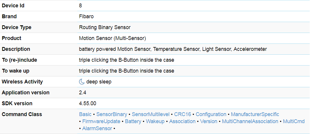

What's the problem ?
Re: ZDDX xml
Posted: 15 Dec 2018 22:10
by pierre2302
It is this information that no longer appears.
