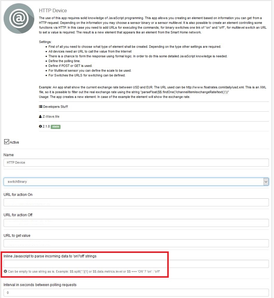

I want to implement my Homematic bidcos devices as HTTP DEVICE in Z-WAY. Switching on and off works without any problems. What I have not solved yet, is the query of the current device status. As a return value, I get an XML response. I am still not sure which parse string I have to enter in the HTTP DEVICE property field "Inline Javascript to parse incoming data to 'on'/'off' strings", to get the right device status back to Z-Way.

I could solve the problem. I had to enter the following values in the two fields below:
"Inline Javascript to parse incoming data to 'on'/'off' strings" --> $$.findOne('/state/datapoint/@value') === 'true' ? 'on' : 'off'
"Interval in seconds between polling requests" --> 5
