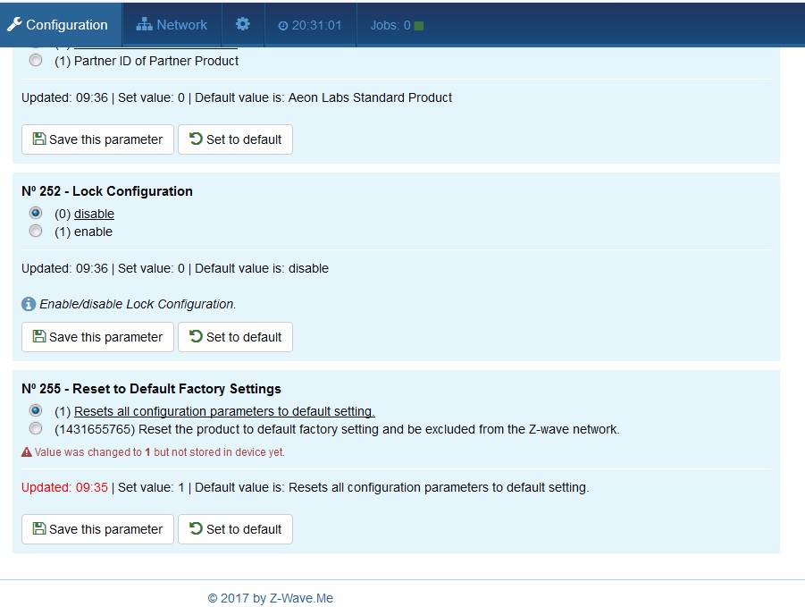

I own an Aeotec Siren Gen5 (https://aeotec.com/z-wave-siren), but it is impossible to configure it via Z-Way (2.3.6).
Everytime I open the configuration page (normal or expert gui) all configurations are reset to default settings (see attached screenshot).
Is it possible to avoid this behaviour?
..and the correct parameter to set the sirens sound is 37 (not 1) -> https://aeotec.freshdesk.com/support/so ... ameter-37-
edit:
got it via experts commands...
