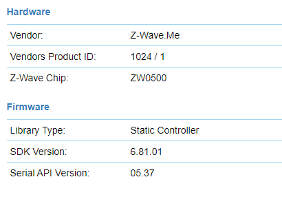

Can't update from 05.37 to 5.39 using z-way expert ui.
Attached device info, no changes loading UPD_FIRMWARE_UZB_STATIC_2ch_ZME_05_27_04000001_ZME_05_27_04000001.bin

Re: uzb firmware upgrade issue
The file is 39->39 (to switch channels). Looks like you are using a wrong file
Enter token all and use the UI to do it. No need to download files.
