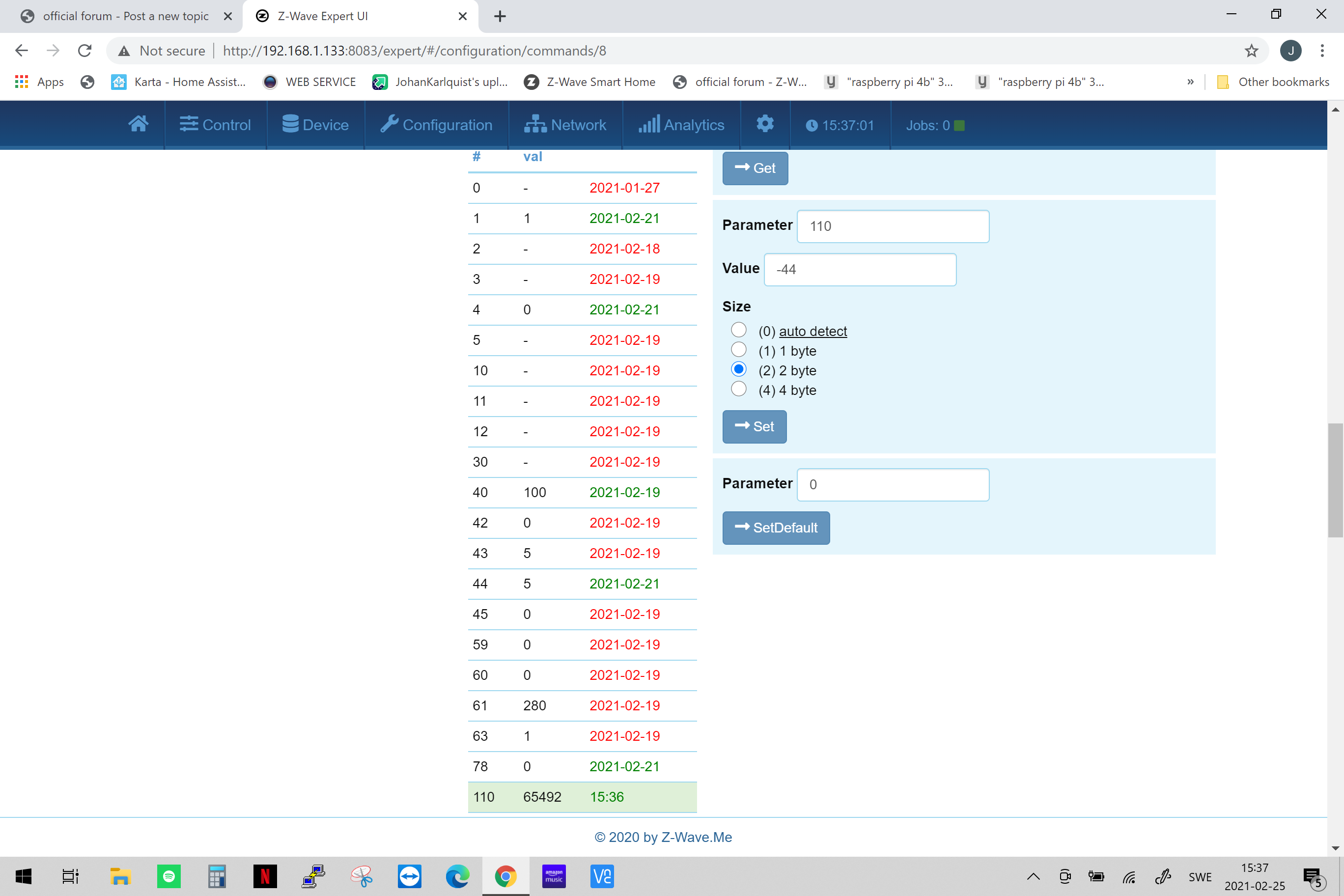

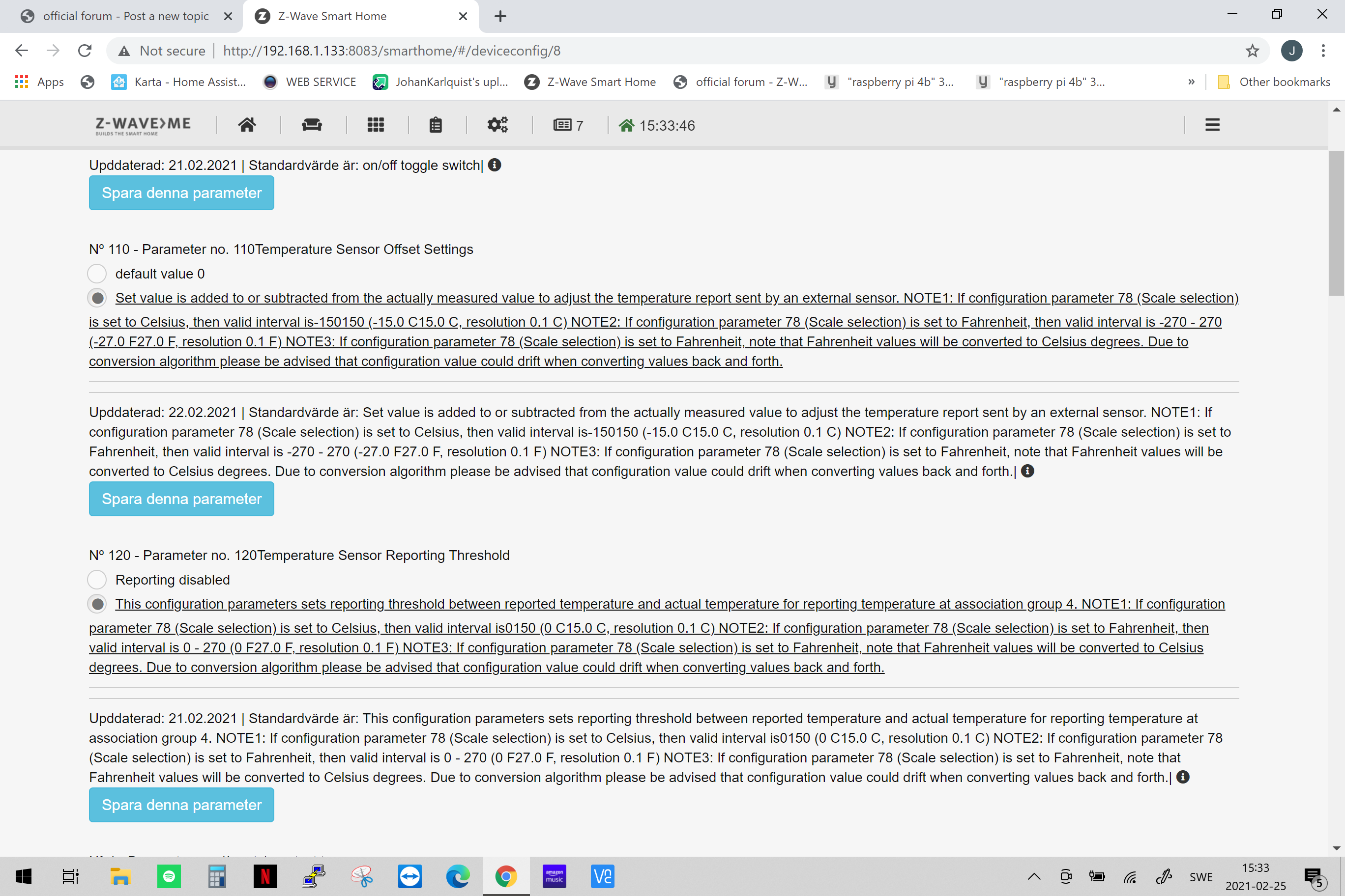

when adding my Qubino thermostat 2, ZMNKID1 i cant change the value for parameter 110,
it only show checkboxes. and doing it in expert will result in error, exempel i need to lower the temp with -44 (-4.4C)
the device starts clicking and showing 65492 and no change is made to the displayed temperature.
if i change it to 44 (without -) then i changes to this but it doesnt change the display temp.
i have the same behavior on 7 devices (tested on a total of 8 devices all doing the same thing)

I doubt that the expert mode accepts negative numbers. You will have to convert your input.
I don't know ZMNKID1, in other Qubino devices 0°C = 32536. I suspect that the description is wrong.

il talk to qubino and they claim it should be -44 thay are sending new thermostat 2 modul to me with a modified firmware to try, if it works they will update my other qubino thermostat 2.

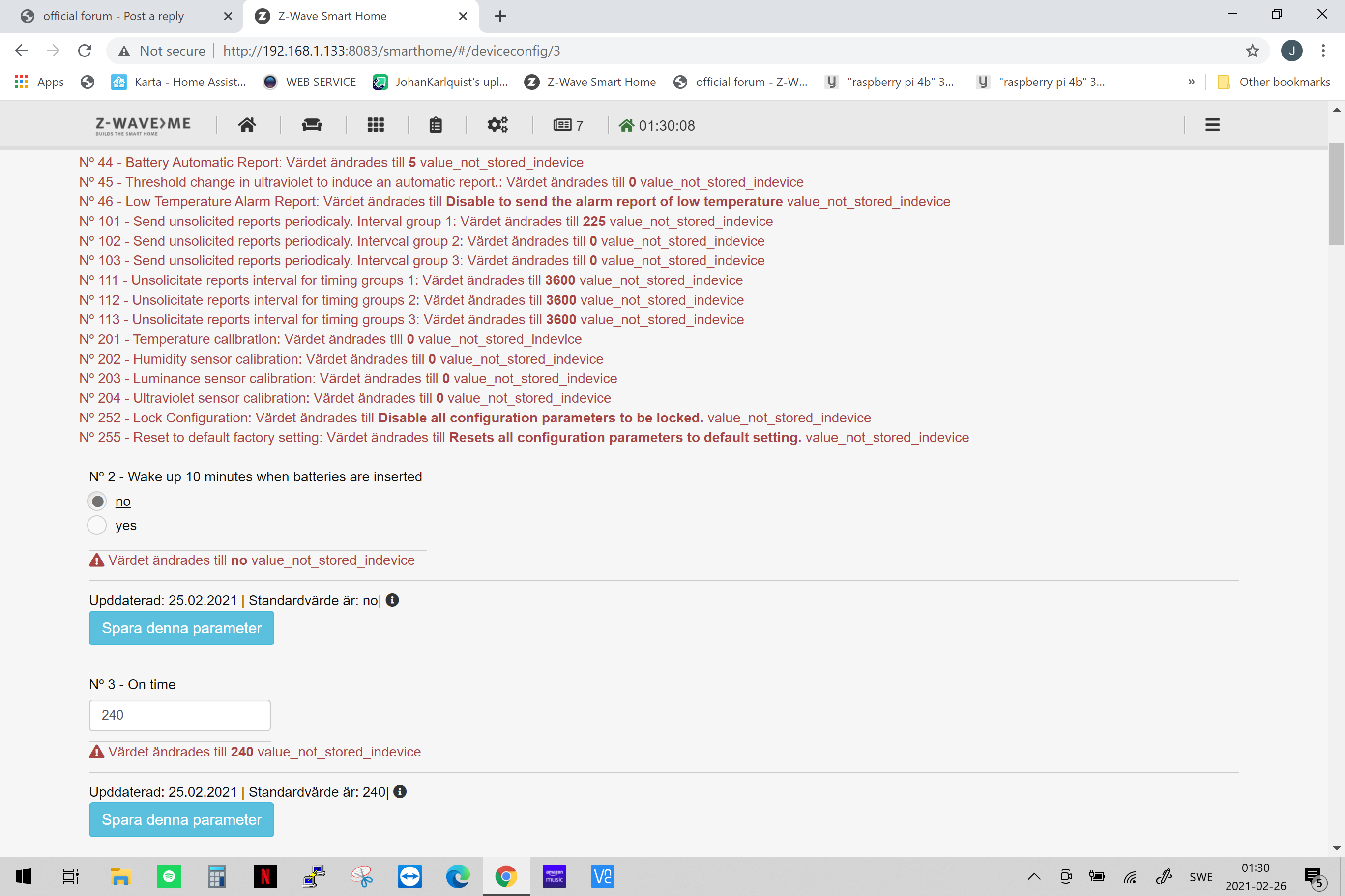

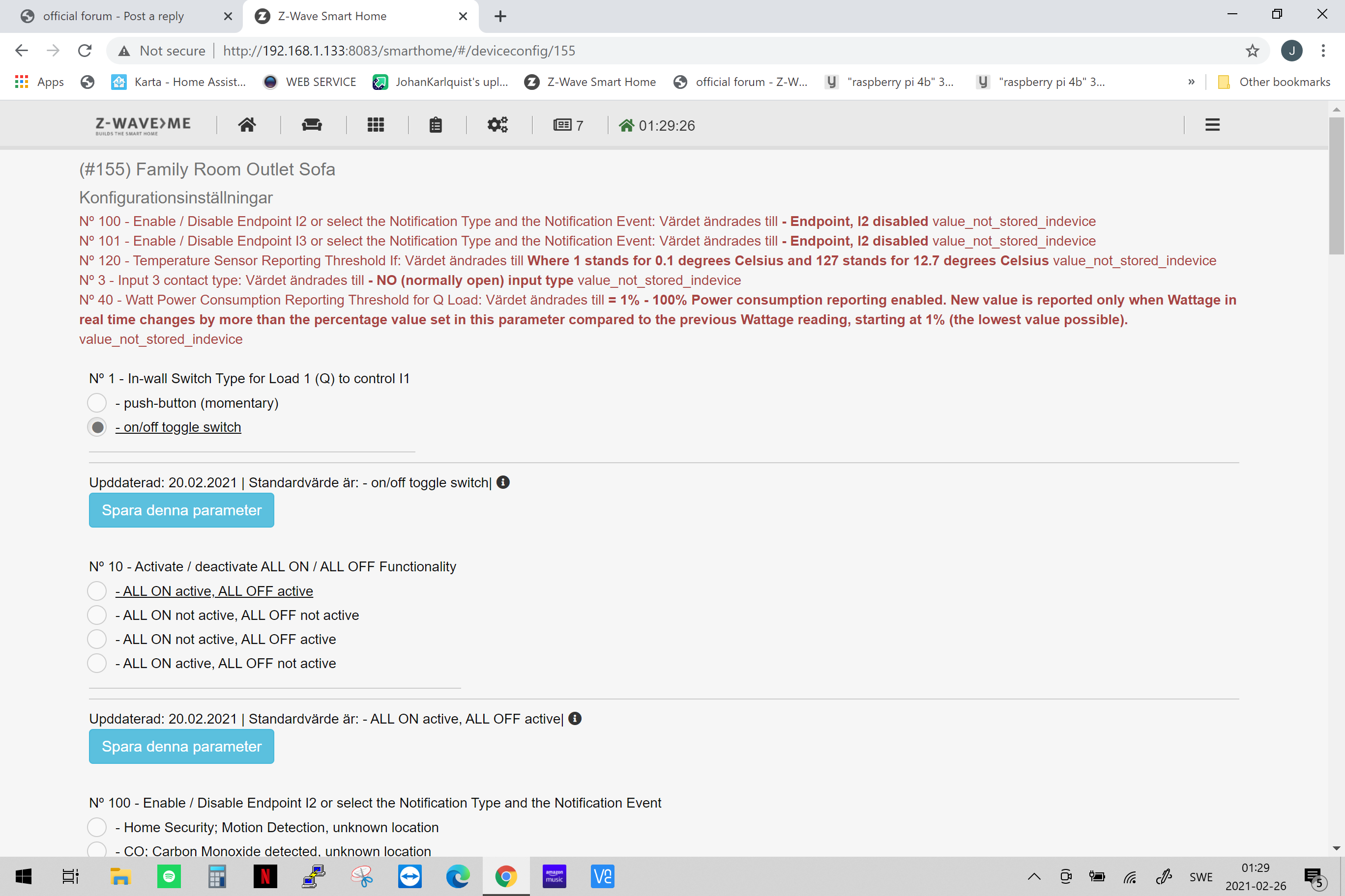

questone, basically every device i ad, it chooses the wrong type, instead of EU version i pick some other version, then when i manually set it to the correct devices it displays error in settings, the device is in default state.
Is this normal?
