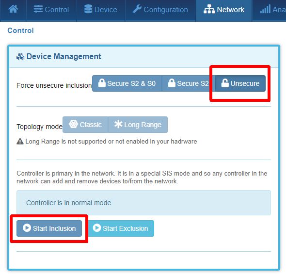

Using the expert UI (http://[IP]:8083/expert), exclude the device and then include the device again with the include set to be done in "Unsecure" mode, as shown below:
unsecure inclusion.jpg (45.12 KiB) Viewed 12318 times
You can confirm the device's security mode by looking for a yellow open padlock in the Security column here: http://[IP]:8083/expert/#/device/type

seattleneil wrote:
28 May 2022 03:16
Unfortunatly It doesnt matter if added with secure or unsecure, the same error message appear in the log and the command is discarded. I guess we have to wait for the next version as PoltoS said...
