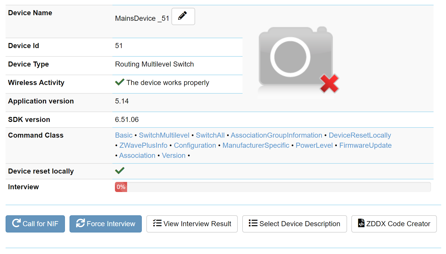

I have a device that failed during inclusion.
I can't remove it as it is not in the list to remove.
Is there a manual command to remove a failed node?
dev51 dead.png (96.46 KiB) Viewed 72646 times
Re: Manual Remove Device - Failed during Inclusion
Try first to exclude it. If it does not help, try to ping it (on the device statuses page) - it will be marked as failed and waiting for deletion.
