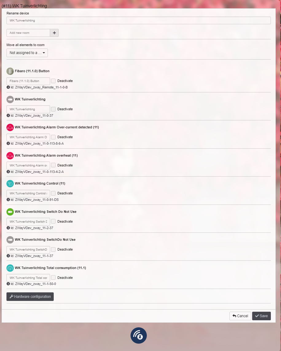

Please go in http://127.0.0.1:8083/smarthome/#/zwave/devices/11 and check if the corresponding item is hidden
Re: FGS-213
The Normal device view of the FGS-213:
The current consumption is missing.

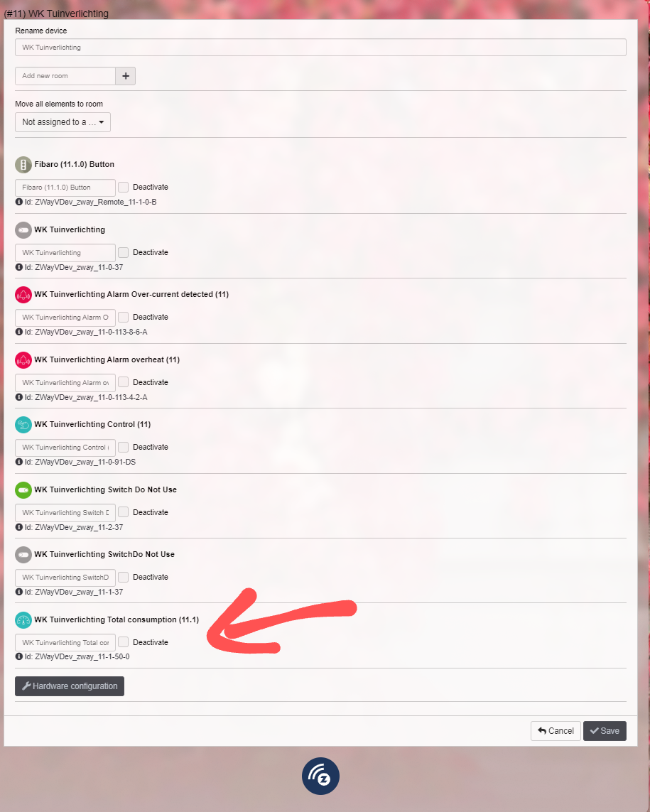

Don't you ask for this device? It corresponds to the one you see in the Expert UI
- FGS-213~2.png (460.19 KiB) Viewed 65909 times
Re: FGS-213
Yes, I have a 11.1 entity for the FGS-213. But only one for KWh. The current consumption is missing, athough in the expert interface Watts are shown (see post 5). For the FGS-223 there a two 6.1 entities. See the screenshots for both devices below.
FGS-213, one entity (only kWh):
FGS-223, two entities (kWh and Watts):

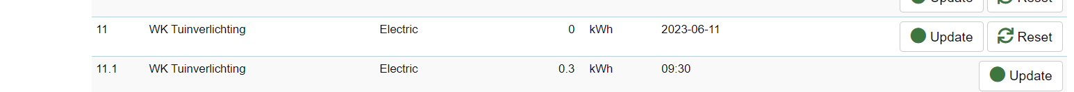

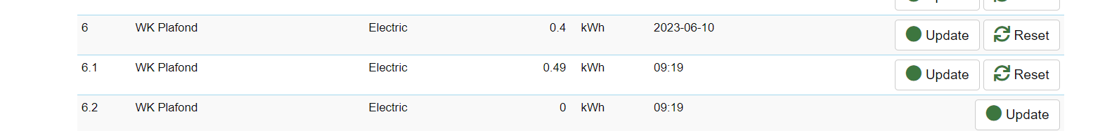

Please show the Meter data tree in expert UI for 6:1 Meter and 11:1 Meter
Re: FGS-213
I openend the following page for the below screenshots: http://127.0.0.1:8083/expert/#/control/meters
I hope this is the correct Meters view?
FGS-223, has three entities:
FGS-213, has entities :
