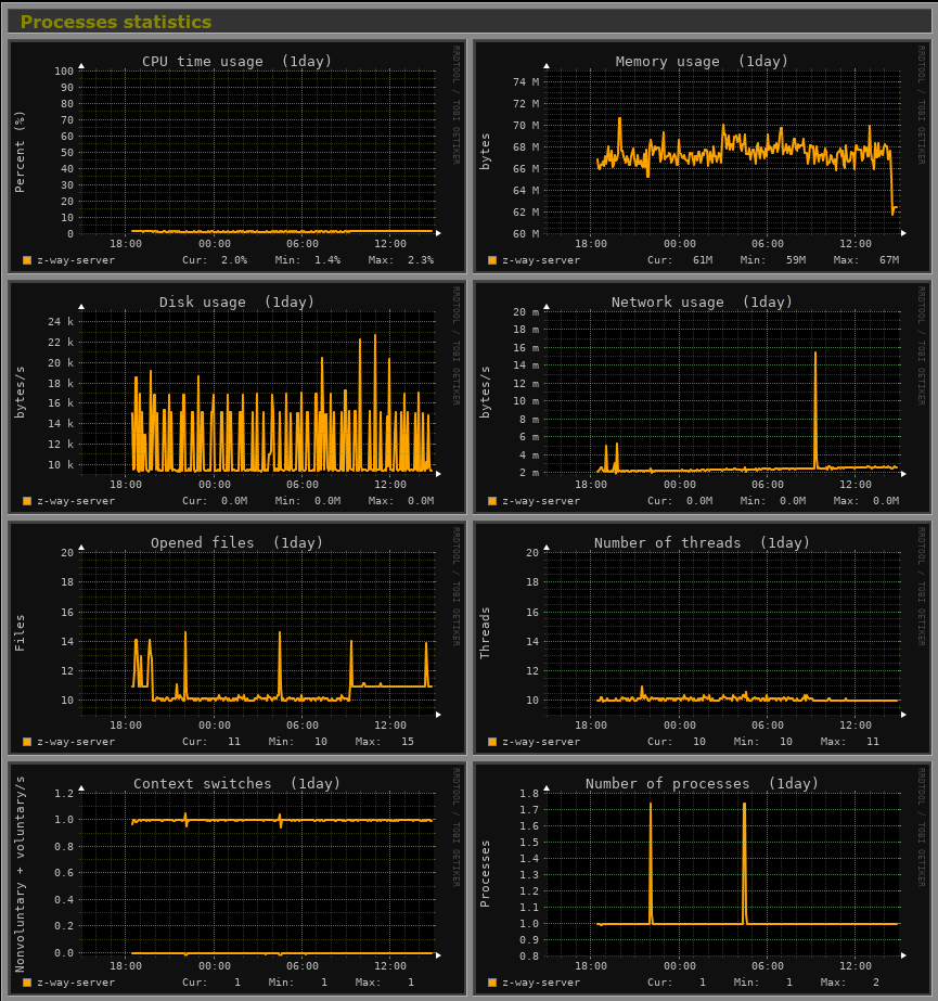

piet66
Posts: 281
Joined: 04 Feb 2017 17:00
Monitorix
Post by piet66 »
I see the advantage of monit in the automatic restart after failure abort.
Those who don't need that and prefer a graphical interface can have a look on Monitorix (http://www.monitorix.org/).
Already in standard view, it provides a lot of information.
In /etc/monitorix/monitorix.conf, section <process> you can add user processes for monitoring.
Example for ZWay:
<process>
	<list>
		#0 = httpd, sshd, ntpd, mysqld, proftpd, clamd, imap, sendmail, named, smbd
		1 = z-way-server
	</list>
	<desc>
		httpd = Apache
		imap = Dovecot
		named = Bind
	</desc>
	rigid = 2, 0, 0, 0, 0, 0, 0, 0
	limit = 100, 1000, 1000, 1000, 1000, 1000, 1000, 1000
</process>
For displaying the graph, you have to enable 'process' in <graph_enable> section.
Screenshot 2022-11-26 at 14-55-46 raspberrypi Monitoring.png (153.07 KiB) Viewed 91744 times

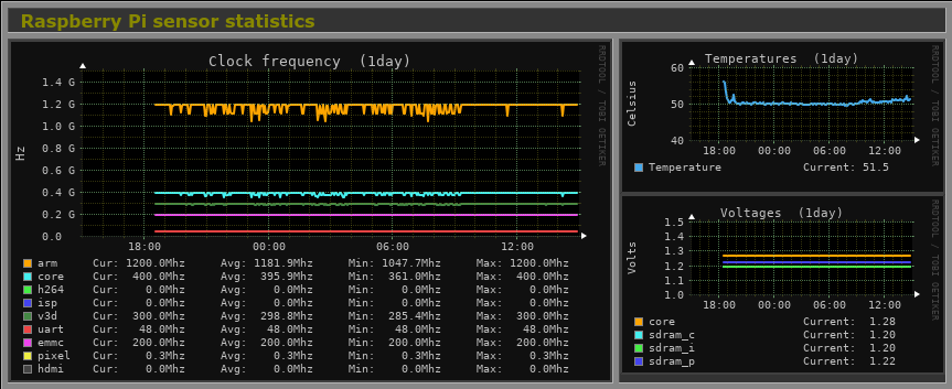

Enabling 'raspberrypi' displays Raspberry Pi specific sensor values.
Screenshot 2022-11-26 at 14-58-04 raspberrypi Monitoring.png (57.34 KiB) Viewed 91744 times
