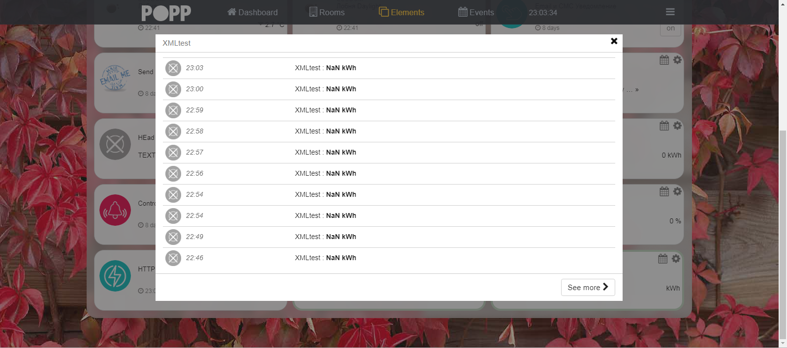

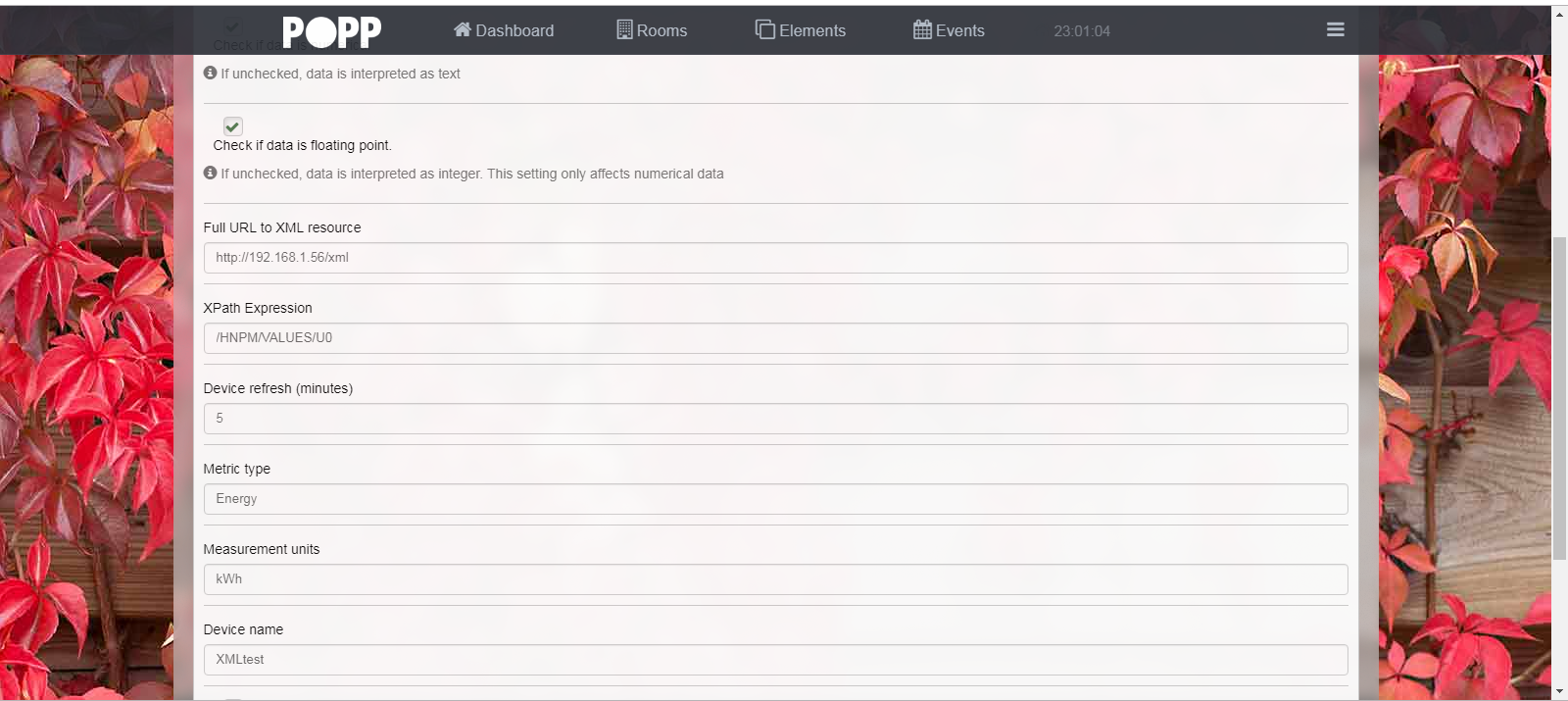

Why can't I get data from XML?
<HNPM xmlns="hnpm.xsd">
<VALUES localtime="_localtime_">
<UPTIME>1202398</UPTIME>
<U0>222.90</U0>
<I0>11.18</I0>
<W0>2469</W0>
<WH0>15902625</WH0>
<MEM>18136</MEM>
<ADCU0>2</ADCU0>
<WIFI>-55</WIFI>
<RECONNECTS>747</RECONNECTS>
<OUTPUT16>0</OUTPUT16>
<DHTT0>0.00</DHTT0>
<DHTH0>0.00</DHTH0>
</VALUES>
</HNPM>
