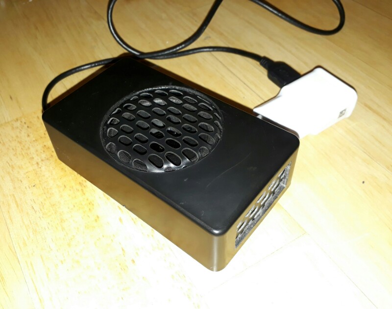

I needed (wanted) a networked door chime to use in my z-wave gateway.
I considered ordering an Aeotec Doorbell, but this is not available in Europe. I looked for other alternatives within the given price range, but I found nothing, so I decided to build my own, which eventually proved to be even cheaper.
Required hardware:
- Raspberry Pi Zero (W): 10€
- Adafruit I2S 3W Class D Amplifier Breakout - MAX98357A, 6€
- a speaker (I've opted for Visaton FR 7, after a failed experiment with a cheaper option), 5€
- a power supply, I just reused a phone charger (consider one capable of 1.2A or more)
- a plastic box, 3€, but I started with a cardboard shoe box
