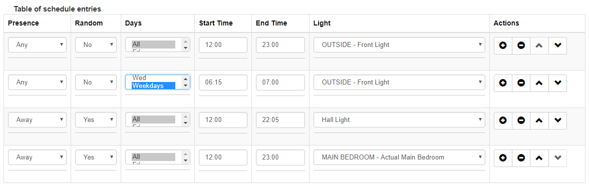

After a few re-thinks here's a new version - 0.1.0.
This module was inspired by the table format used by tomshuette in the WeeklyTimer module and which is based on 3 of the great modules from maros: BaseModule, Presence and Astronomy.
The table of scheduled entries each entry allows you to specify presence, day of week, start/end times and a light. Additional you can indicate entries to be randomised.
Additionally:

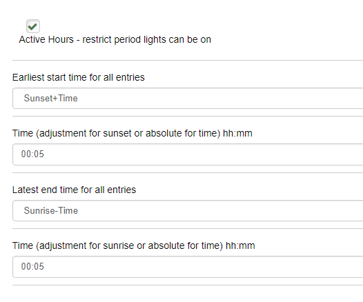

  • You can define active time - only between the start and end time will lights be on. This be defined using sunrise/sunset and absolute times
  • You can specify one or more sensors to active some or all of the lights
You can try this using token "beta_jet11x". Please make sure you install BaseModule, Presence and Astronomy first and set your longitude and latitude in Astronomy (which is used to calculate sunrise and sunset). I hope they'll be some interesting feedback.

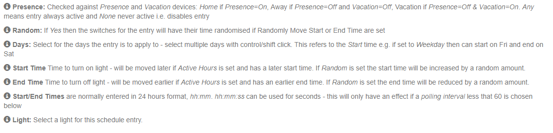

There's fairly detailed help available within the module on what the different columns in the table mean.

I've made a lot of changes to make this module more usable - now at version 0.1.0. In particular the ability to define an active period, usually based on sunrise/sunset and also selecting lights (binary and multilevel) from a simple drop down list, replacing the very awkward config strings I was using previously.
