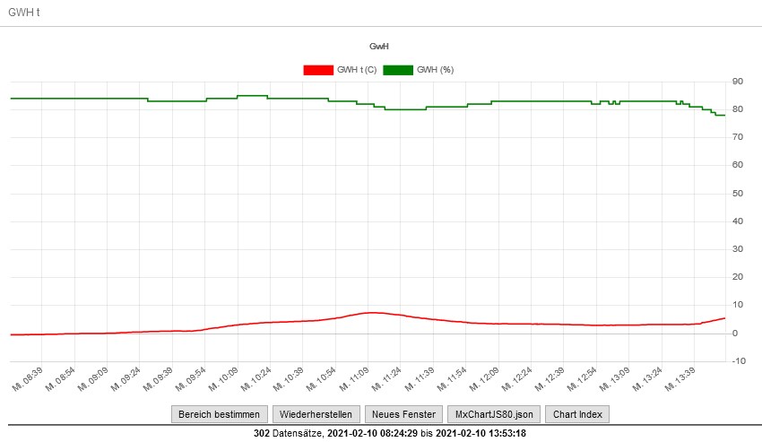

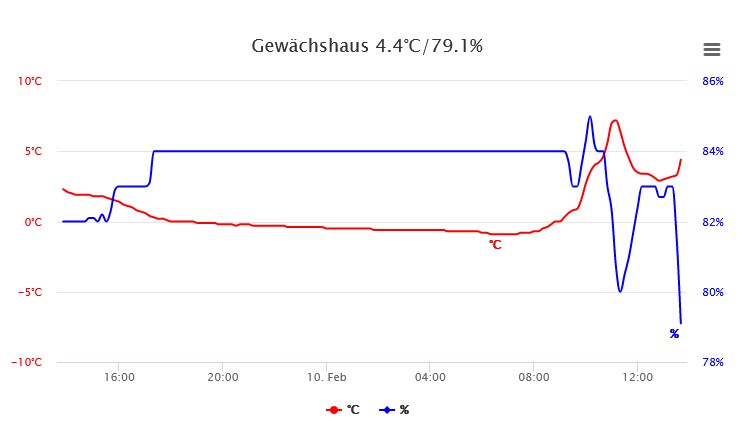

Attached 2 pictures about the sense of 2 axes - A temperature/humidity sensor is a real use case.
The ranges are very different, so that it maybe not possible to check it at first view.
Same will be for room temperature - have no sample for MxChartJS in this time...
Again - it is only an idea to make it a bit better to use ;)
No very good visible temperature range:
just using highcharts (with 2 axis):
