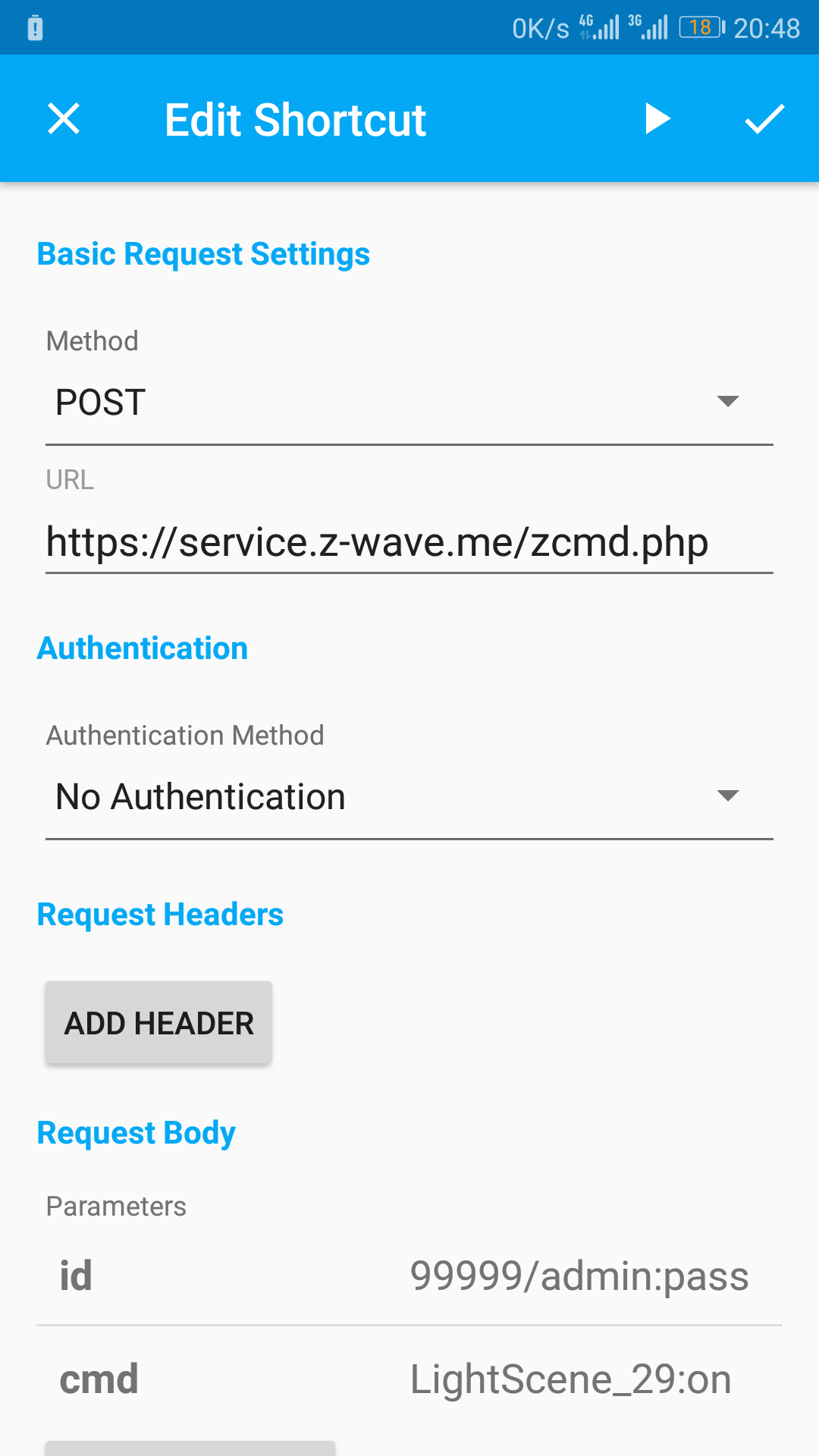

Hi! This is planned. For now you can use an HTTP Shortcuts app. There was a white paper somewhere...
Here is my config:

Nice, are both widget support and Tasker support planned?
I actually have something halfway similar to what you're describing, only it's through Tasker (because I'm also automating the api calls) and I'm using the ZAutomation api, which in my current setup only works locally. Changing to your approach looks like it will work outside of the home wifi as well, but does it support getting values as well as setting them?
I'd appreciate a link to the white paper, if you should find it. :)

I got your approach working for turning things on and off, but how do I set for instance the level of a multilevel switch? And how do I read a device value?
Re: Widgets and Tasker support in Android app
You can use a scene to dim lights to some specific levels. And then activate the scene
