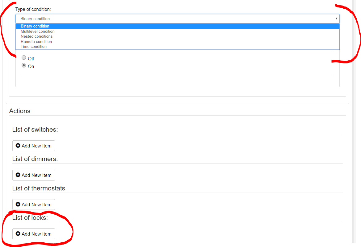

Im on Zway Version 2.3.6 beta for WD and i got no locks under conditions? I got locks under actions, but no locks under binary-, multilevel, nested-, remote-, time condition. And i need a lock based condition, not a lock based action.

I don't have any locks so just assuming - try to use Dummy Device associated with your lock and use that Dummy Device in Logical Rule.
