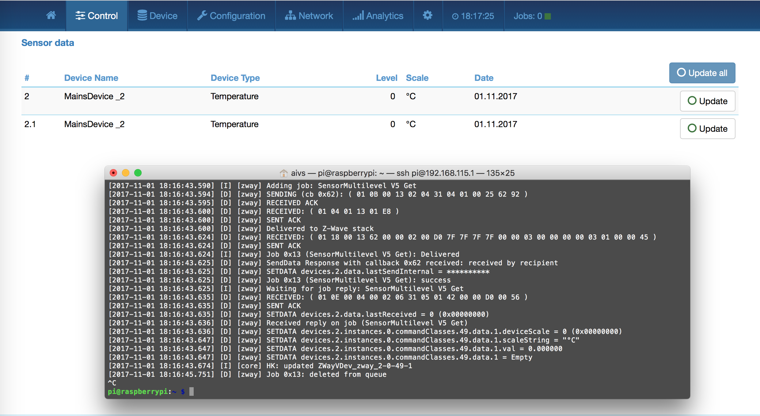

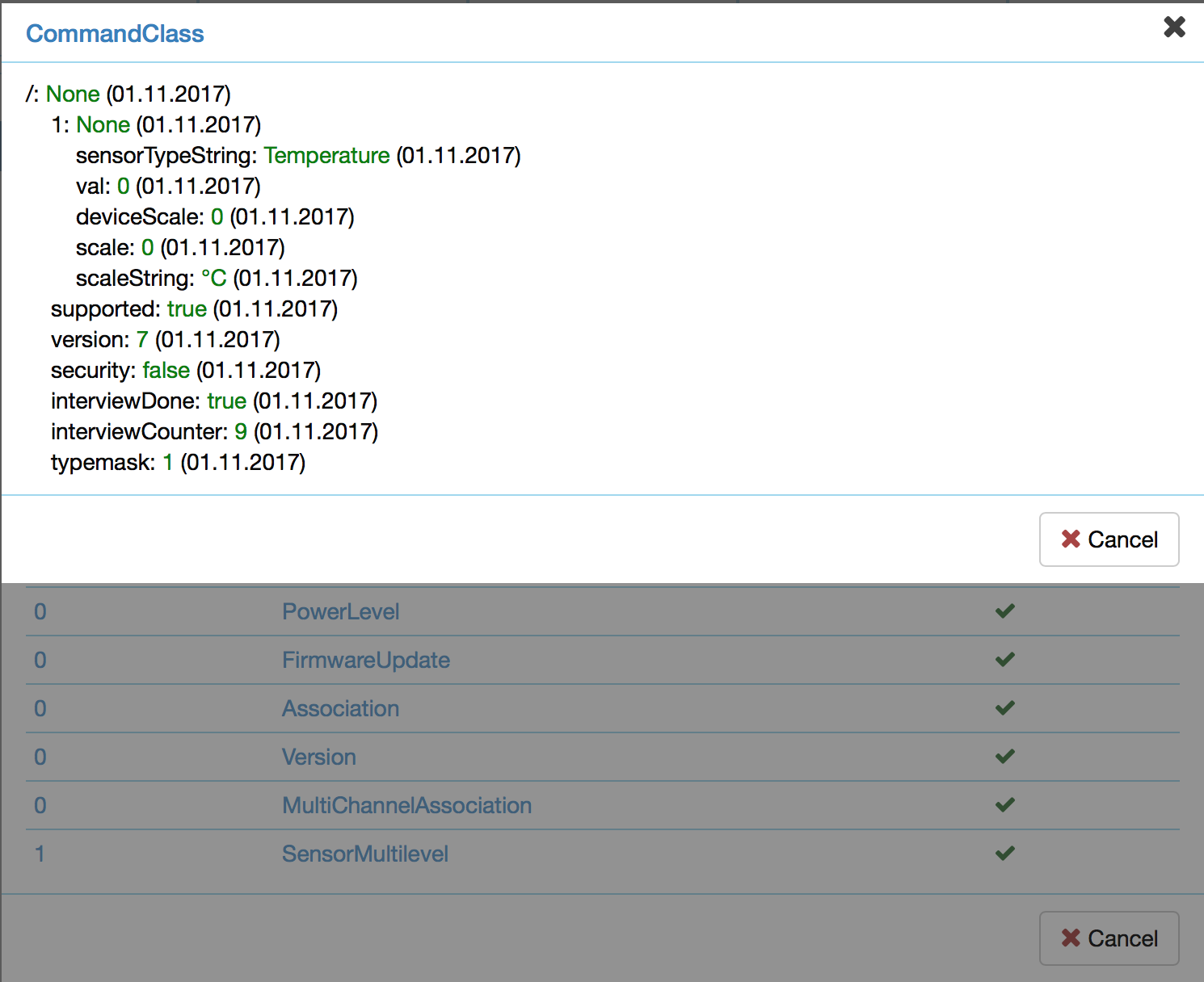

Sketch works correct in RaZberry. I can get temperature, sensor type and scale correct.
