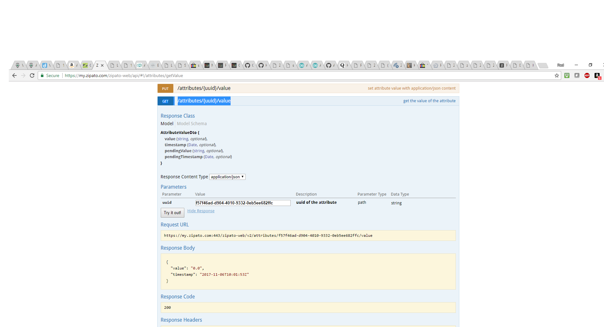

You can access the entire API through a web interface here:
https://my.zipato.com/zipato-web/api/
I've just checked and it appears you can read the values ok this way, so a workaround seems possible.
If you look at GET /attributes/{uuid}/value and enter the uuid into the appropriate field you should get some output similar to the attached screenshot

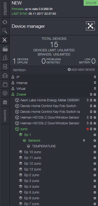

The uuid is obtained by going into to device manager and then opening up the appropriate z-wave device.
In the attached screenshot you can see I have a device zuno with 13 Endpoints, clicking the settings cog against zuno->EP1->Sensors->TEMPERATURE contained the uuid I needed for this end point.
