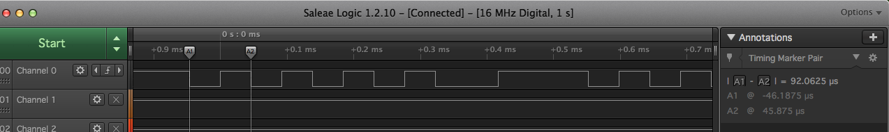

So, what I have:
1. When I connected Z-Uno to power supply using 3V/5V/Vin I always have the same frequency with your code 10.86kHz(92.0625us):

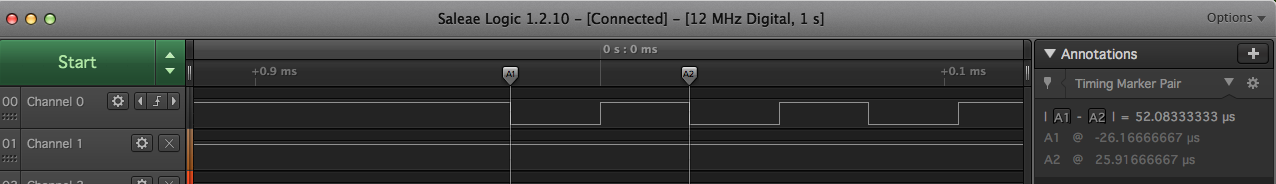

2. When I connected Z-Uno using USB and external power supply I always have this 19.2kHz (52.083us)
If I connect Z-Uno using USB cord without data cables I always have the 1 behavior too.

p0lyg0n1
Posts: 242
Joined: 04 Aug 2016 07:14
Re: Z-uno is running much slower on PC power than on charger
Post by p0lyg0n1 »
The same results. 2-nd is with external power supply connected to USB. The smallest time period means highest frequency.
