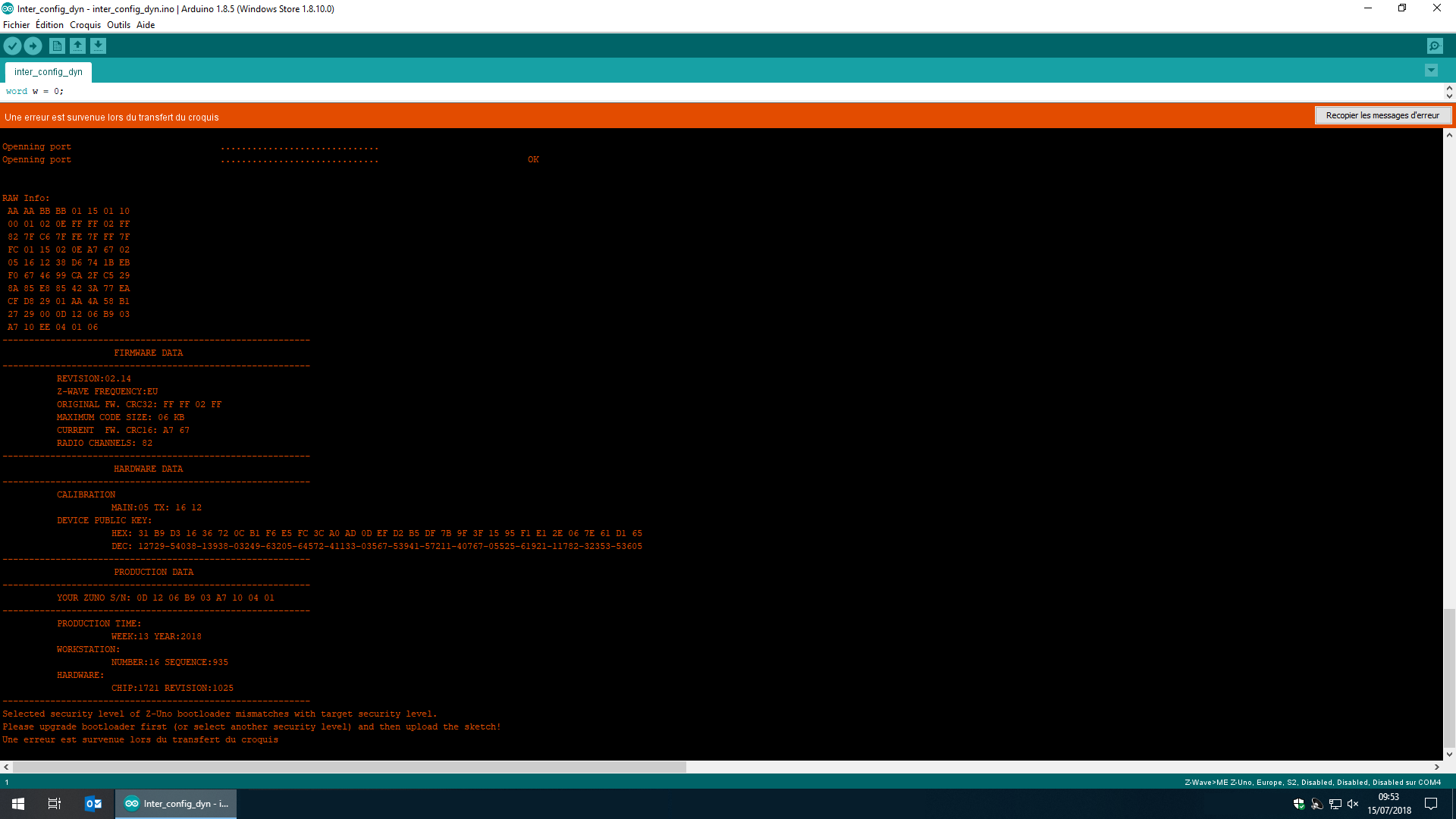

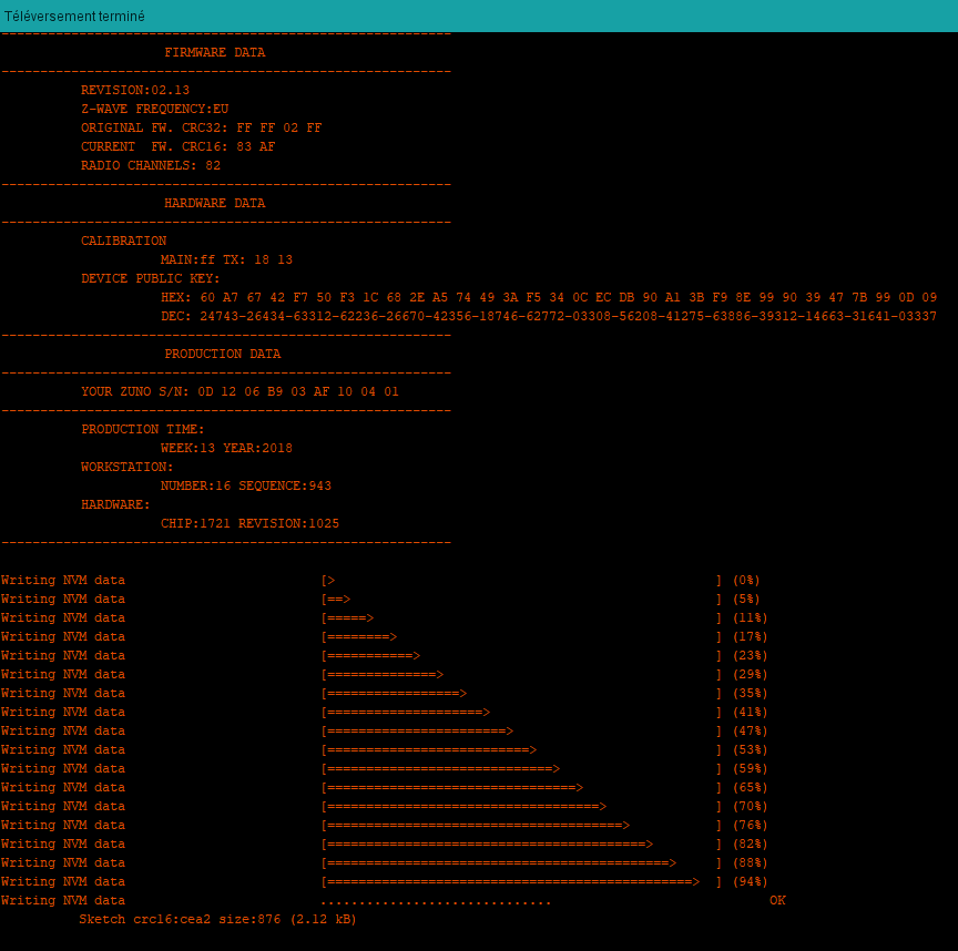

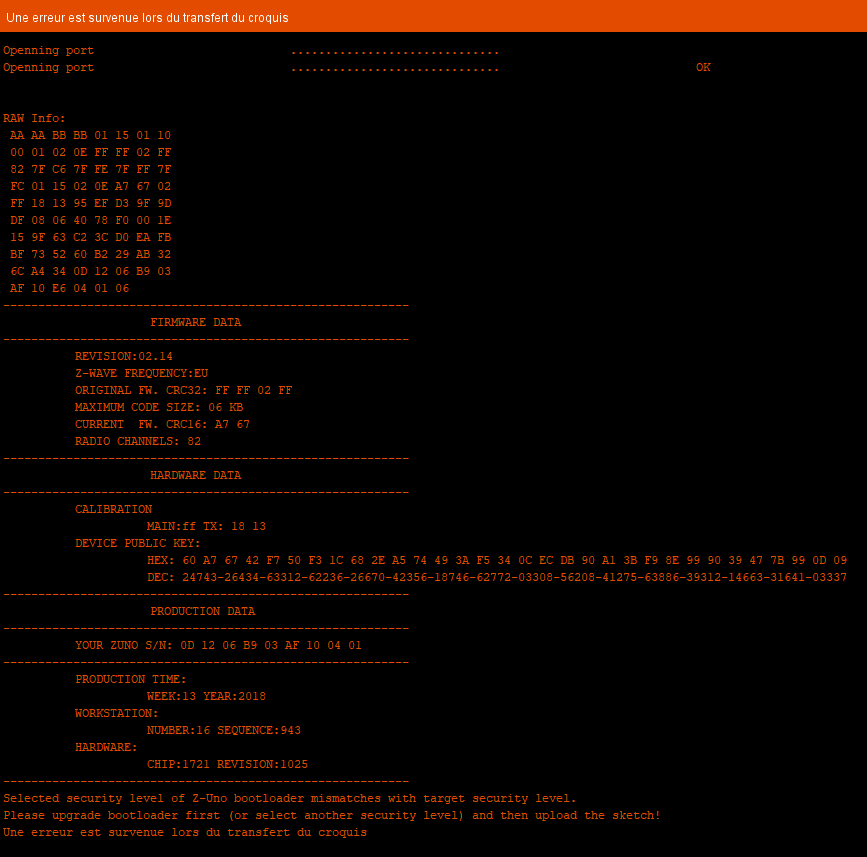

I found a another issue with the compiler and S2 security.
The burning of the bootloader is going very well, and when l load the program to the z-uno we have a mismatch error.
I did the test with compiler 1.6.5 and 1.8.5 and it's the same problem.
It works very well with version 2.1.3.
With 2.1.3 : With 2.1.4 : Is there anything else to do with 2.1.3?
Param : Thank.
Eric.
Param : Thank.
Eric.

Re: New 2.1.4 beta
Hi, we work on the pullup issue. S2 issues was in the first beta. Could you check that you use "the last" beta and have this issue too? I couldn't reproduce it on my build.
Thank you! You really help us a lot!
Alex.

Re: New 2.1.4 beta
Really with pleasure, this z-uno is great. And thank you for all these developments.
Great for pullup resistors, I hope it will not be too complicated.

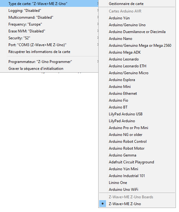

For S2 issues, I just reproduced the problem with the latest beta (by remove all from packages/Z-Uno & staging/packages and reload board from test-ucxx repository). The compiler is 1.8.5.
I Restart Arduino IDE.
I change the card type, the frequency (europe), the security (S2) and the programmer.
I upgrade the bootloader first and ok.
I upload the sketch just after and error.
it does not matter to me because I'm not going to use security, but maybe it can happen to someone else
Thank you for your reactivity
Eric.
