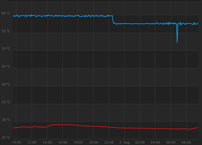

Well, so I've tried to modify one of my older devices and implement the above method of sending unsolicited reports.
- It has 2 multilevel sensors/channels.
- Each channel sends a report if the value has changed, but not more often than one report per 10 seconds per channel.
- Each channel sends at least one report per 1 minute, even if the values are steady.
With 2 multilevel sensors, this works great and both values got updated regularly, as you can see on the enclosed chart.
2 channels.JPG (30.38 KiB) Viewed 47219 times
But, if I use the same approach for a sketch with 7 sensors, it still suffers from the original issue - some of values got stuck, while other are being updated regularly :(
