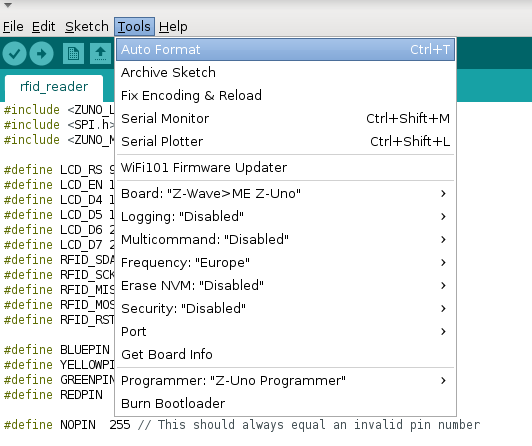

budm
Posts: 11
Joined: 29 Mar 2018 17:16
Re: Firmware 0.0.0 error
Post by budm »
Ok, naked Zuno, went into reset mode (+BTN, +RST, -RST, -BTN).
Set Erase NVM=All, cleared the logs, uploaded an empty sketch. Result says invalid Firmware 0.0.0. Think it also said "Found corrupt S2 key", which was something I'd noticed before I hosed it.
Set Erase NVM=Disabled, moved the log out of the way, uploaded an empty sketch. Same error, firmware 0.0.0.0. Both logs are attached, as well as a screenshot of my tools menu.
logs.zip
(14.39 KiB) Downloaded 2961 times
budm
Posts: 11
Post by budm »
Screenshot.
