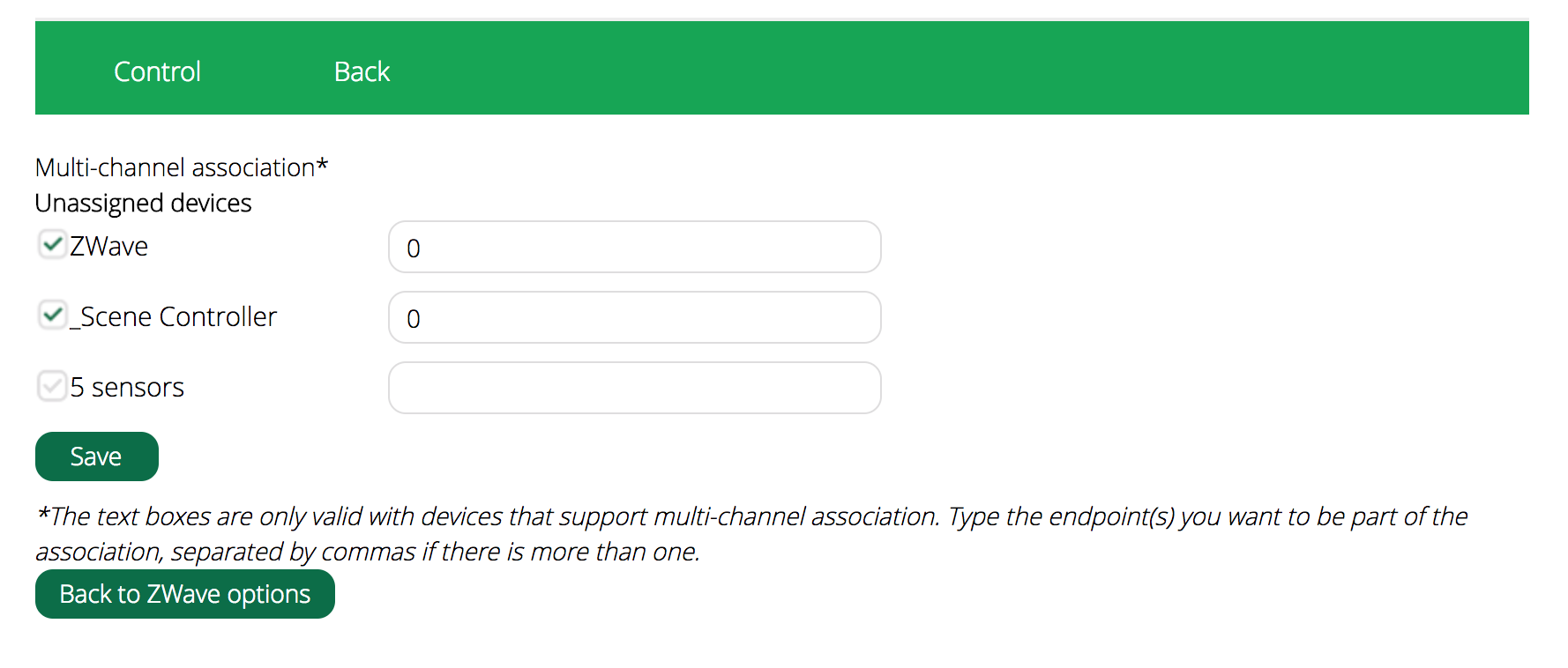

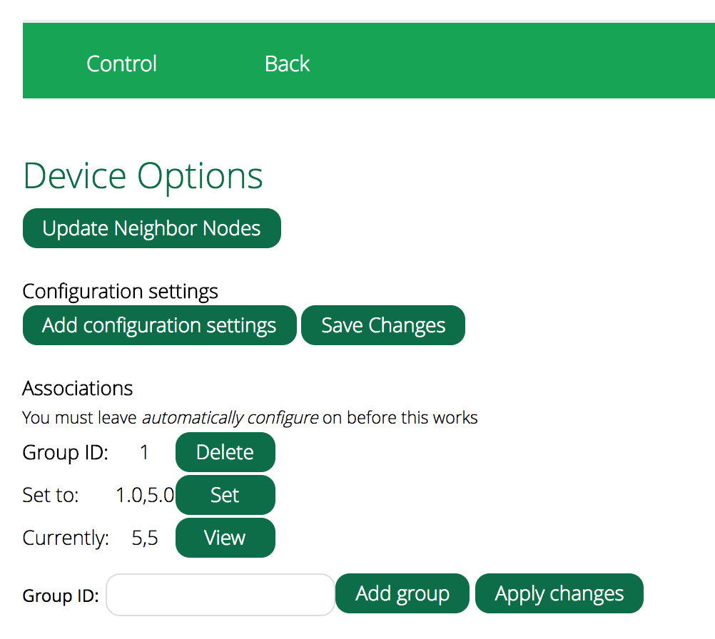

Z-Uno sends reports from the channels using multichannel association to Lifeline, but by default Vera sets basic association. So at first need to add Vera into Z-Uno multichannel association.
Choose general widget --> Device Options --> 1 Add Group --> Set to: Z-Wave 0; _Scene Controller 0
After applying the Association settings should be like this
Now Z-Uno can send Sensor Binary and Alarm via multichannel association.

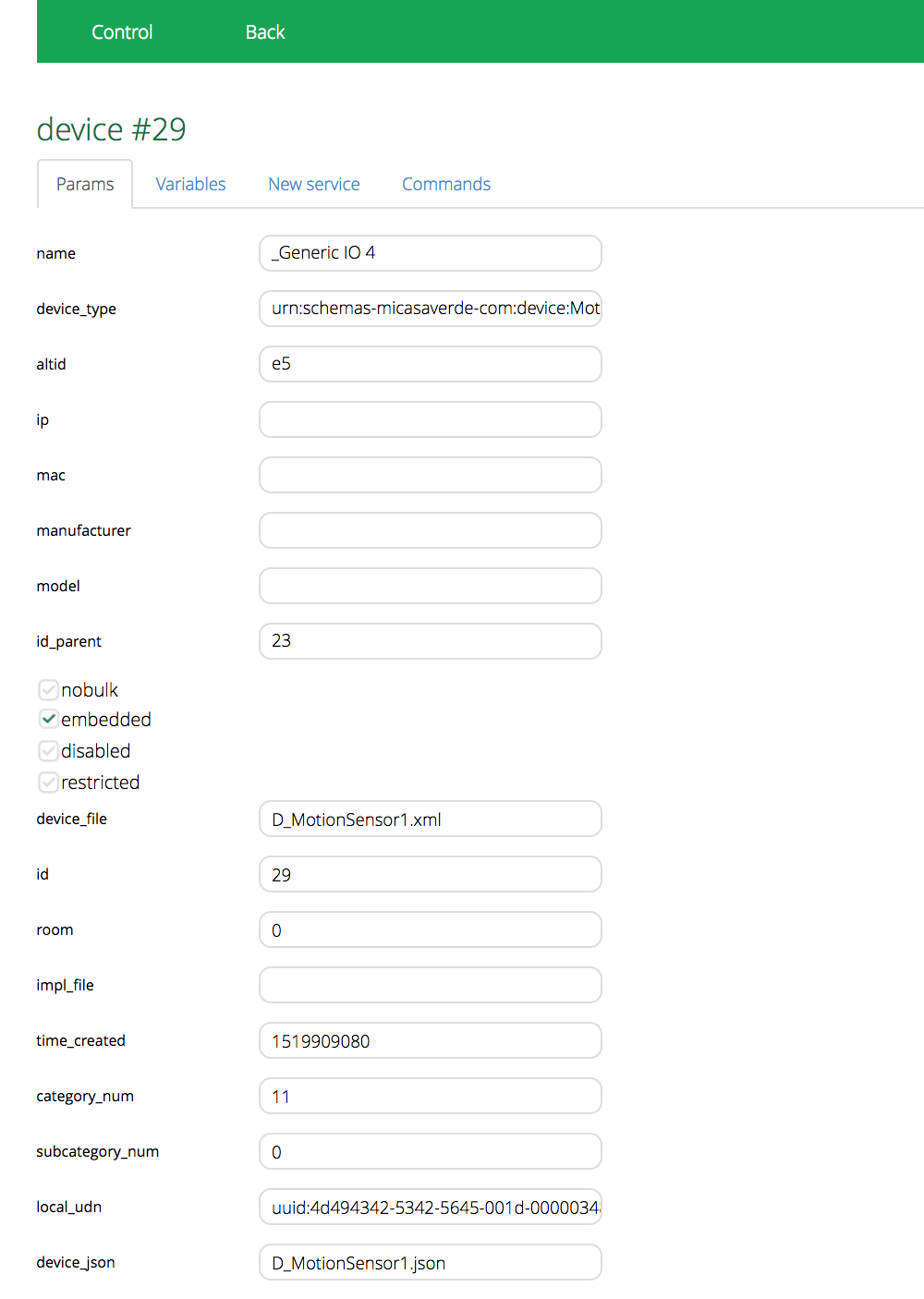

Need to set the widget type to D_MotionSensor1
In each widgets --> Advanced
device_type = urn:schemas-micasaverde-com:device:MotionSensor:1
device_file = D_MotionSensor1.xml
device_json = D_GenericIO1.json
Should be like this

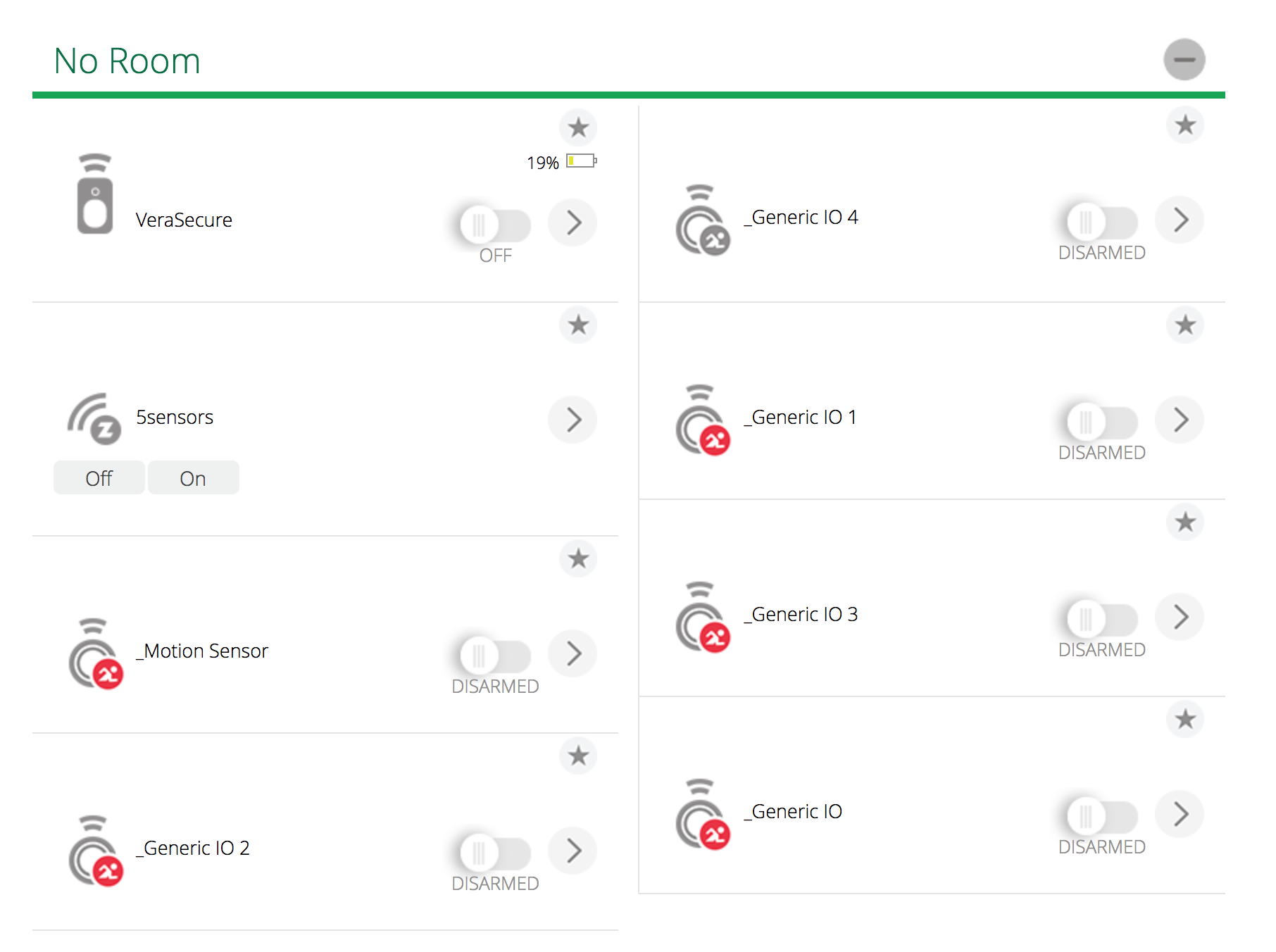

OMFG!!! aivs sir, you are a LEGEND!!!
I simply added that association and, seconds later, everything lit up like a Christmas tree! Have also shorted the pins to ground and, instantly, each one caused the green LED to do a data transmission and the Vera updated the relevant sensor status.

Sorry, but I still cannot get this to work.... The "root/parent/1st channel" device value in Vera updates every time the Getter in my z-uno code gets called but the "child/2nd channel" device value only updates occasionally when its Getter is called... its value is often up to 15 minutes behind.
In the Vera UI I under the "Parent" device under "Device Options-> Associations" I have added a Group ID of 1 with ZWave and _Scene Controller checked.... so the Association "Set to" is "1,2".... but "Currently" just lists "2".

Looks like I finally got this working.
My last problem was solved by not only checking but also entering a "0" in both the ZWave and _Scene Controller fields when setting those 2 associations for the "parent" device.
