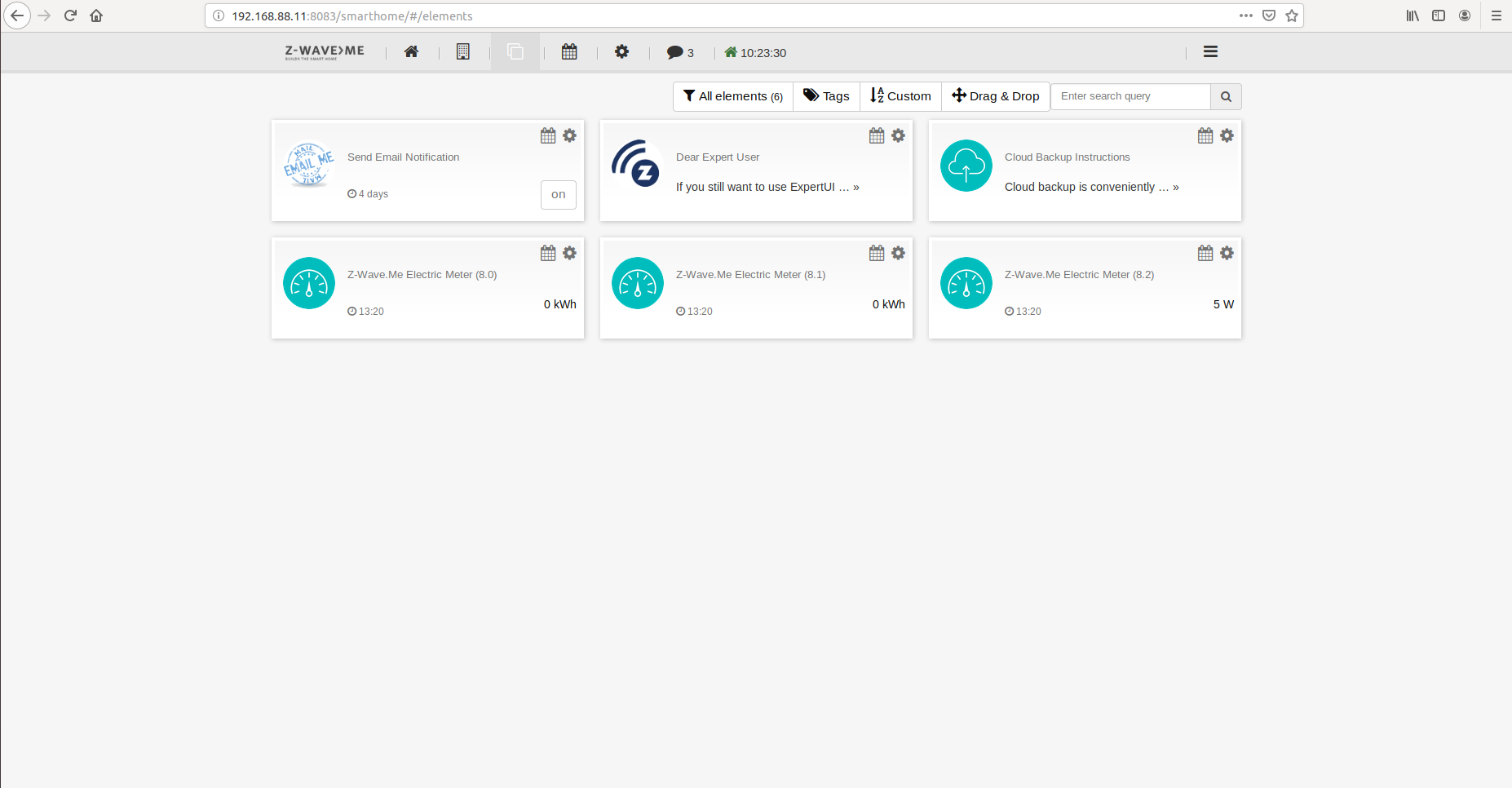

Re: Only get values from one channel (have two channels)
Post by rkv »
There are no problems. Code works fine with Razberry.
