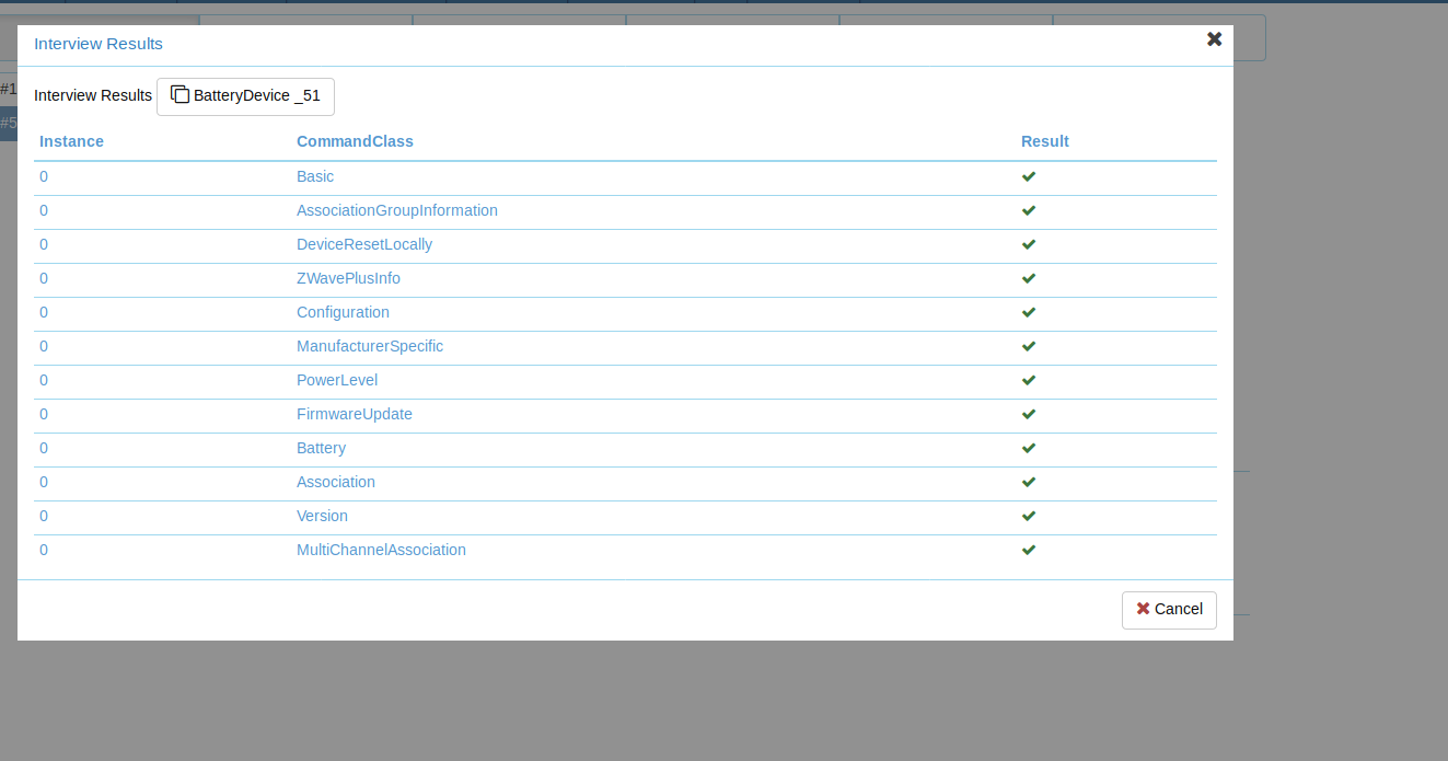

samsonbox wrote: ↑
16 Jul 2019 22:55
I have a problem with the
ZUNO_SETUP_SLEEPING_MODE(ZUNO_SLEEPING_MODE_FREQUENTLY_AWAKE);
with the loop I call
  zunoSetBeamCountWU(10);
  zunoSendDeviceToSleep();
but the device does not wake up any more. The Battery and wake_up command class is also missing on the contoller side. But in react on any commands.
This is works fine in 2.1.5 update. Try to exclude your zuno and then include. If it won't work try other zuno.
Also wake_up command class can be only in always sleeping device.
Here are the interview results for your code.
