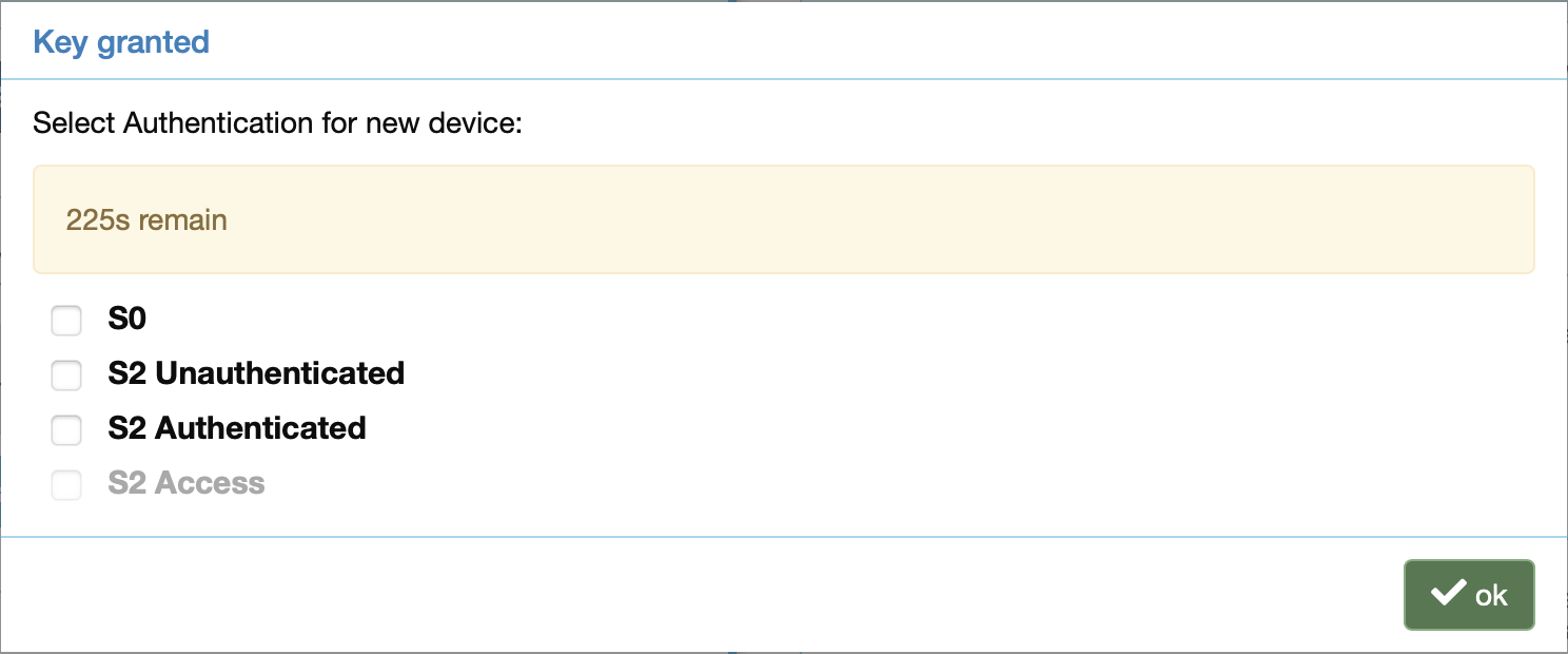

I'm currently investigating the Z-Way Expert UI software. There is something where I would need some help to understand Z-Way's functionality.
When performing an inclusion of a ZGM130S based always on slave, the full interview session works very fine when using the Network->Control->Device Management: "Force unsecure inclusion" switch. When not using that switch, however, selecting an unsecure inclusion (see attached screen shot) the Z-Way controller still seeks for a "KEX Get" response.
16.03.2021 14:43:16 1 58 100 kbps -75 dBm - - KEX Get
which, of course, will not be answered by the Silicon Labs ZGM130S Z-Wave stack and therefore will result as a "unfinished interview". There are no issues with any of the other options (S0, S2 unauthenticated, S2 authenticated) for inclusion which do finish 100%. Just the one way of inclusion finishes with an "unfinished interview" for command class SECURITY_2.
Any advice? Thanks for your help!.
Screen Shot 2021-03-16 at 14.52.03.png (62.46 KiB) Viewed 9393 times

Re: Z-Way: Unsecure Inclusion Issue
If you don't want to grant any key, use unsecure inclusion. Otherwise the interview will fail for an obvious reason.
N2641D
Posts: 30
Joined: 06 Feb 2019 13:34
Post by N2641D »
Thank you for your information. However, I lack the logic that Z-Way itself wouldn't use insecure inclusion if none of the security options were selected. But my thought might be too philosophical :-)
May be you are right. We should think about it.
