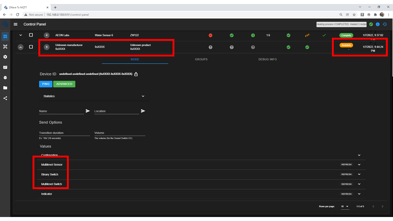

Note the first and fourth definitions are for BINARY SWITCHES. It doesn't work and the issue is at the Z-Wave internals level. Here is a screenshot of what is created in the Z-Uno MCU (using ZWave JS API viewer to view, see
https://github.com/zwave-js for more information):
- ZWave_Node_create.png (89.85 KiB) Viewed 11785 times
You can see that only three device values have been created for the Z-Uno including only ONE instance of the Binary Switch.
Moreover, is appears that an attempt to create a multiple device class somehow screws up the api calls on the Z-Uno and at least on my viewer, node interview fails and doesn't return after initial boot (upper right corner is a stuck node interview request on the Z-Uno).
