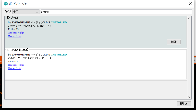

I installed Arduino 1.8.19 by downloading directly (not through Microsoft Store App).
In Arduino board manager, I installed Z-Uno2 3.0.7.

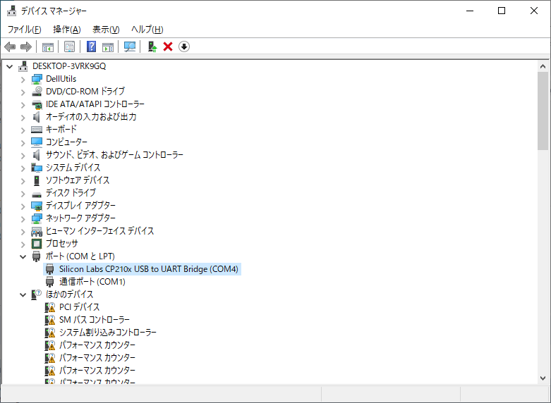

The Z-Uno 2 is recognized as COM Port 4.

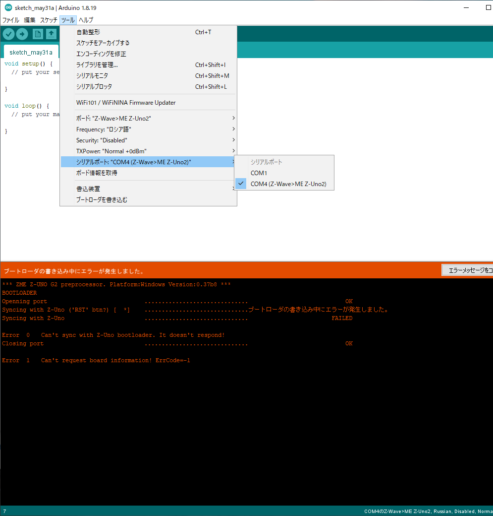

When I try to burn boot loader, it shows "Syncing with Z-Uno ('RST' btn?) [ *]" and after around half minute it failed.
*** ZME Z-UNO G2 preprocessor. Platform:Windows Version:0.37b8 ***
BOOTLOADER
Openning port                            ..............................                            OK
Syncing with Z-Uno ('RST' btn?) [  *]    ..............................ブートローダの書き込み中にエラーが発生しました。
Syncing with Z-Uno                       ..............................                        FAILED
Error  0	 Can't sync with Z-Uno bootloader. It doesn't respond!
Closing port                             ..............................                            OK
Error  1	 Can't request board information! ErrCode=-1
In addition, I have also tried the Z-Uno2 (Beta) 3.0.9 and same error occurs.

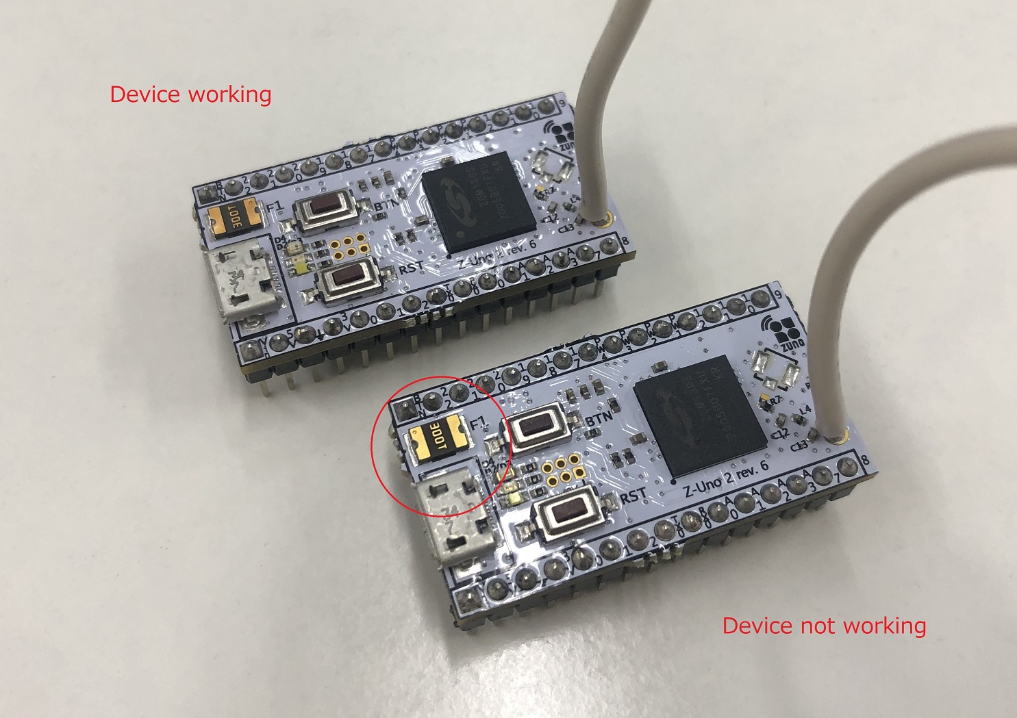

And one stupid question is that I discover that the parts next to the USB is not in the same direction with the other device that works well.(I think it does not matter, but just in case).

The 300T thing is facing "the wrong way" on my Z-Uno as well, btw.
