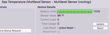

The one thing I find that is interesting/different is that my controller reports "extra" information for the Z-Uno:
Even though I have the Z-Uno set up as mains powered, I get a battery report and two extra pieces of information, Current Load and Total Usage. I wonder if it's manufacturing reports for these other non-existent sensors?

It's the latest version of Indigo talking to a Z-Stick Gen 5.
So I poked around a bit, and Indigo thinks that a Manufacturer ID of 0115 and Model ID of 01100001 is the ZME_ITEMP made by Duwi. Apparently that device doesn't send unsolicited reports and must be polled, so that is what Indigo is doing.
I found a setting in Indigo to disable polling, but I'm still getting these duplicates. I'm guessing it's got to still be something with the way that Indigo is interpreting the device. Not a big deal.
