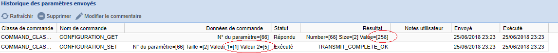

2)
When I write and read a configuration parameter from the box eedomus, I do not recover what I write (screenshot) :
I use COMMAND_CLASS_CONFIGURATION the CONFIGURATION_SET with for exemple the param 66
I write 1*256 + 5 and i read only 256
it seems as if the last byte was not written

2)

1)-2) Works ok. I do it on Z-Way with my Razberry.

With dynamic code, the config is not always save in eeprom. When I reboot, and when i aks the param with the eedomus box (not by z-uno, i don't place the function zunoLoadCFGParam for keep simple), i have 0.
I excluded / included the z-uno between the two codes to be sure, even it's the same channel.
I have surely make a error, but i don't find where or perhaps the box, but i doubt.
