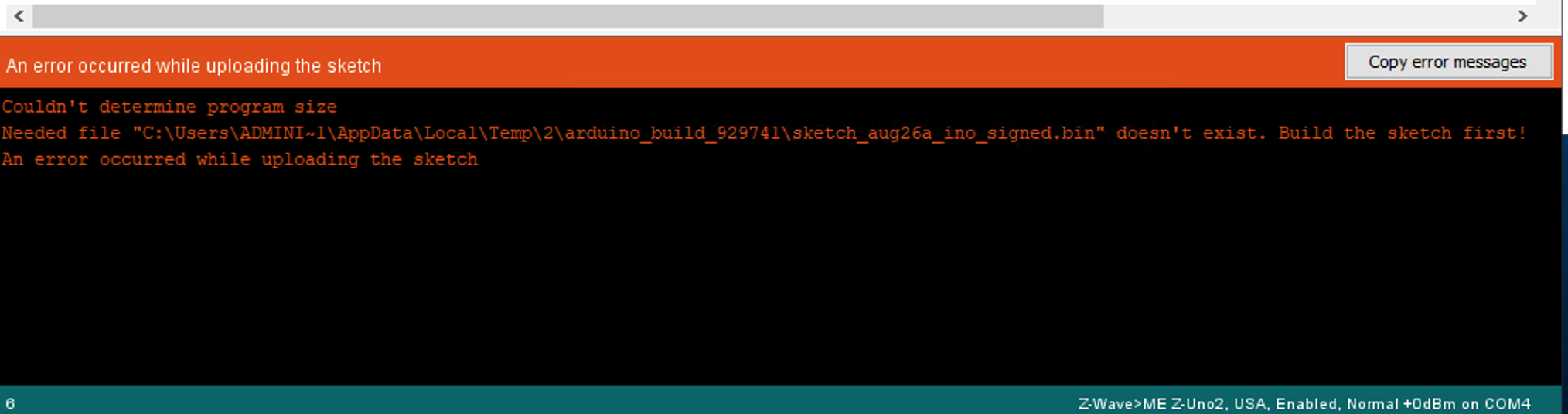

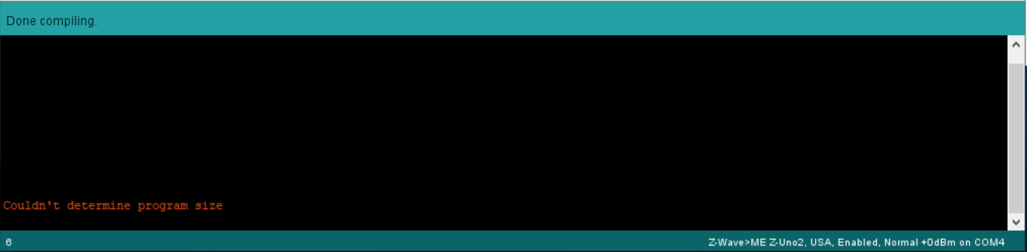

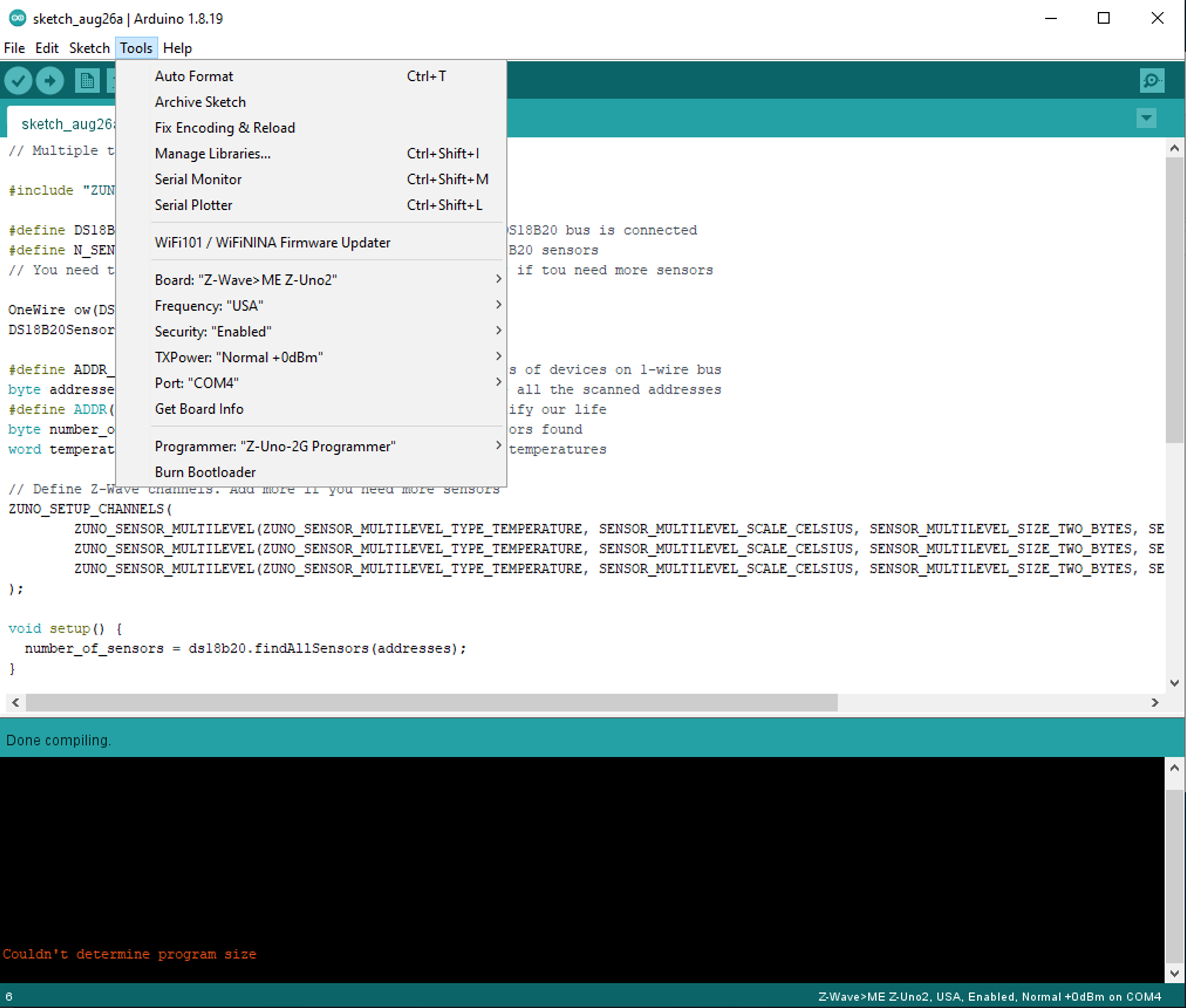

If I click verify, the only error is that it cannot determine the size.
I've attached screenshots for the verify and the upload.
Couldn't determine program size
Needed file "C:\Users\ADMINI~1\AppData\Local\Temp\2\arduino_build_929741\sketch_aug26a_ino_signed.bin" doesn't exist. Build the sketch first!
An error occurred while uploading the sketch
