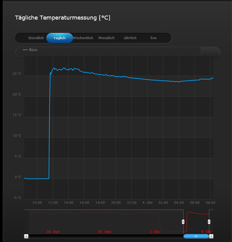

Temperature in HC 2
Temperature in HC 2
An influence of internal interrupts? May be. I can't check this. The Z-UNO was not in the cyclic calling queue of my HC 2. But I don't know, what the Z-UNO is doing with all radio telegrams of the Z-Wave.
Nevertheless, I did some more investigations based on the helpful discussions here. I understood, that there is a problem, using oled.print(float) and zunoSendReport() together. So in the first step I checked what is happening, when I call these methods in different cycles of the main loop. I saw a significant improvement of stability. Instead of about every 140 cycles the device was blocked only every 900 cycles.
That lead me to the last test. Instead of writing a float value to the oled display, I divided into 2 integers, which I write in a sequence to the display (see the attached nasty lines of code ;) ).
With that solution the device isn't blocked anymore and running smoothly as desired :!:
Now I can go on to finish my project of controlling my Mitsubishi A/C systems via HC 2.
The only thing to do is, to create some PCBs and put all the things together in a case :)
