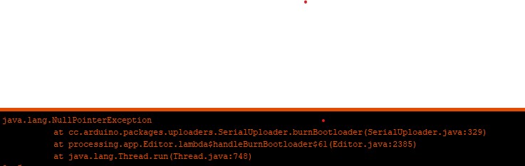

lanbrown wrote: ↑
30 Aug 2022 20:44
If I click verify, the only error is that it cannot determine the size.
I've attached screenshots for the verify and the upload.
Couldn't determine program size
Needed file "C:\Users\ADMINI~1\AppData\Local\Temp\2\arduino_build_929741\sketch_aug26a_ino_signed.bin" doesn't exist. Build the sketch first!
An error occurred while uploading the sketch
I suspect that the problem is with the Arduino from the store - for example, I have this error:
Try installing this version:
https://downloads.arduino.cc/arduino-ni ... indows.zip

amatilda wrote: ↑
30 Aug 2022 21:20
I tried it and the same error. What version of the IDE are you running? I'm not tied to any particular release. This is my first Z-Uno board. I plan on getting a few more if I get it working and happy with the results. I'm mainly looking at using them as temp sensors.

lanbrown wrote: ↑
31 Aug 2022 00:03
amatilda wrote: ↑
30 Aug 2022 21:20
Interesting...
It looks like your Arduino for some reason does not want to work with the z-uno.
"What version of the IDE are you running?" - https://downloads.arduino.cc/arduino-ni ... indows.zip
Can you see after it gives an error again, what is in the folder there? - maybe you have a strict antivirus or something like that.
I mean when trying to upload a sketch:
Needed file "C:\Users\user\AppData\Local\Temp\2\arduino_build_253281\OneWire_temperature_sensor_DS18B20_ino_signed.bin" doesn't exist. Build the sketch first!

amatilda wrote: ↑
31 Aug 2022 00:28
The only file is sketch_aug26a.ino but not the signed version.
Only the Microsoft provided protection is used; so Windows Defender. The firewall portion is disabled though. No threats have been logged according to the dashboard.
Up in the temp directory if I perform the upload, it does create another directory and then it quickly vanishes though.

lanbrown wrote: ↑
31 Aug 2022 01:03
amatilda wrote: ↑
31 Aug 2022 00:28
Let's try another way where there is more control.
Try with Vs Code:
https://z-uno.z-wave.me/vs-code-install/

I tried under macOS and it would upload. I'll try the Vs code either later today or tomorrow.
